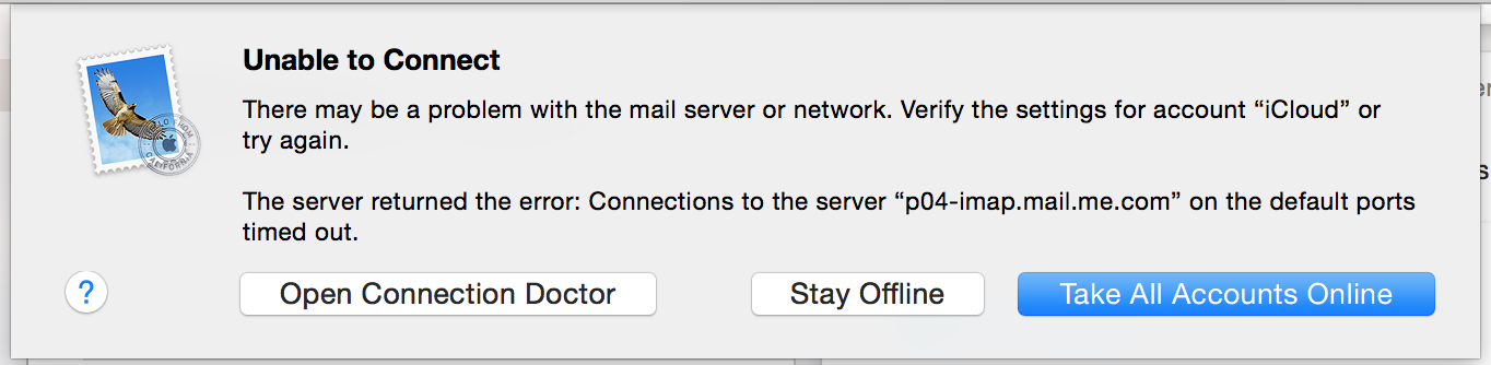

This is happening constantly. Sometimes it fixes itself, sometimes it stays off for days. I've tried disabling mail in the iCloud settings and turning it back on but doesn't seem to do much.
