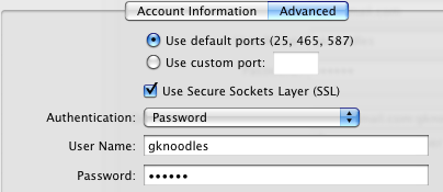

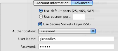

I've found some conflicting instructions on the G Mail web page. On the incoming and outgoing servers in Apple Mail it says to include @gmail.com in your user name field. You don't do it this way at least not for me anyway. This is how I have it set up and it works fine,
https://forums.macrumors.com/attachment.php?attachmentid=274496&stc=1&d=1299348249
https://forums.macrumors.com/attachment.php?attachmentid=274497&stc=1&d=1299348249
