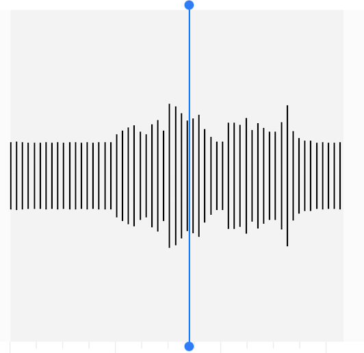

While the sound of this is great, I am getting terrible mains hum on the test recording and presumably will be the same on Skype.
This headset was bought for an X-BOX One and plug directly into the controller on a 4 pole 3.5in Mini Jack.
The hum is worse when I have the USBC charger connected.
You can see the level of the hum compared to my voice on the attach image.
I have found that with my hand touching the MBP anywhere the hum is reduced.
Putting a whole palm on the left of the trackpad reduces the hum by about 80% but it's not ideal.
Do you think this is just a badly/wrongly wired headset? I've tried turning the plug a few times to scrape off any oxide on the connections but that made no difference.
If I just plug in headphones and record using the MBP built-in mic then there is no hum at all.
I had this exact problem. It's a grounding issue.
I'm guessing you're plugged in using the 2-prong plug?
Use the 3-prong plug and you'll be golden.
It's a subtle issue, but what's happening is that you created a ground loop by not using the ground prong on your charger.
your USB-C cable is acting like an antennae, and it's leaking RF noise into the air, creating what Shure calls a "hum field", or an inductive loop, which the microphone is picking up.
A little trick is that you'll notice that the amount of noise will increase and be very stable when you touch the metal shield of the USB-C connector.
