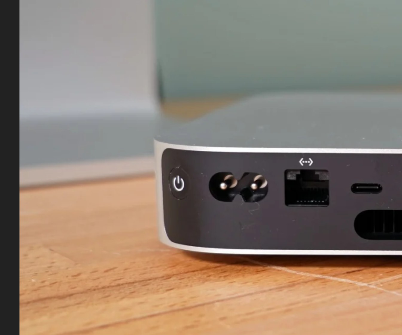

Quick question, when looking at the mains socket of a Mac Mini (M2 specifically), which pin is live and which is neutral? Thanks.
The "correct" answer probably depends on which country you're in and the shape of the plug you're using...?
I don't think it is country specific. Just interested in which pin is which.

On the 2024 manual there appears to be a N near the left pin. Neutral? I can only assume that Apple are consistent and that the left pin of the 2023 Mini is Neutral too.

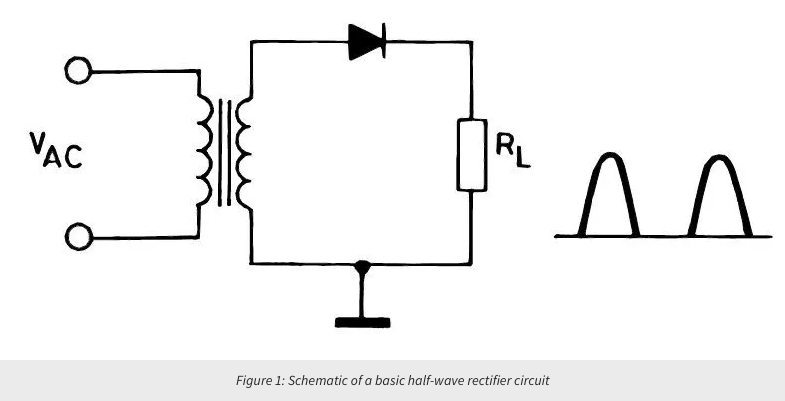

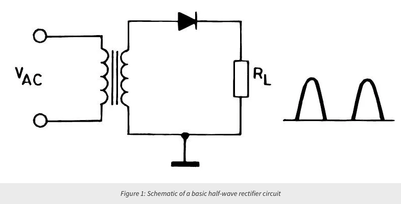

It makes no difference because the rectifier circuit found in the power supply is polarity agnostic. Anything using a C7 connector is polarity agnostic. Give it a hot and a neutral and Bob's your uncle.
Even in more complex rectifier circuitry, the basic premise is the same. Polarity agnostic.
Yeah that. It makes no difference.
The diagram is wrong though. Firstly it’s a switcher and the picture is a linear supply. Secondly there’s no ground on the secondary unless it’s through a cable attached to it. It’s floating and there are capacitors (Y class) between the low voltage side and the high voltage which leak a little current on purpose.
This is incidentally why when you run your finger across the top of a MacBook Pro on charge it feels buzzy at around 50/60Hz.
Totally harmless of course.
Agree on all. Thanks for the clarification.

There is a variant of the IEC 7 connector which is IEC 7P, POLARIZED, which can only be plugged in one way, notice one side is flat, but that is not what Apple uses, they use the unpolarized, figure-8 mickey mouse IEC 7, hence it doesn't matter.

Since the power connector itself is non-polarized (i.e. reversible), inside the power supply itself is where you would find that information. If it was a polarized connector where each pin had to be a specific input, then one side would be squared off like the post above indicates.
