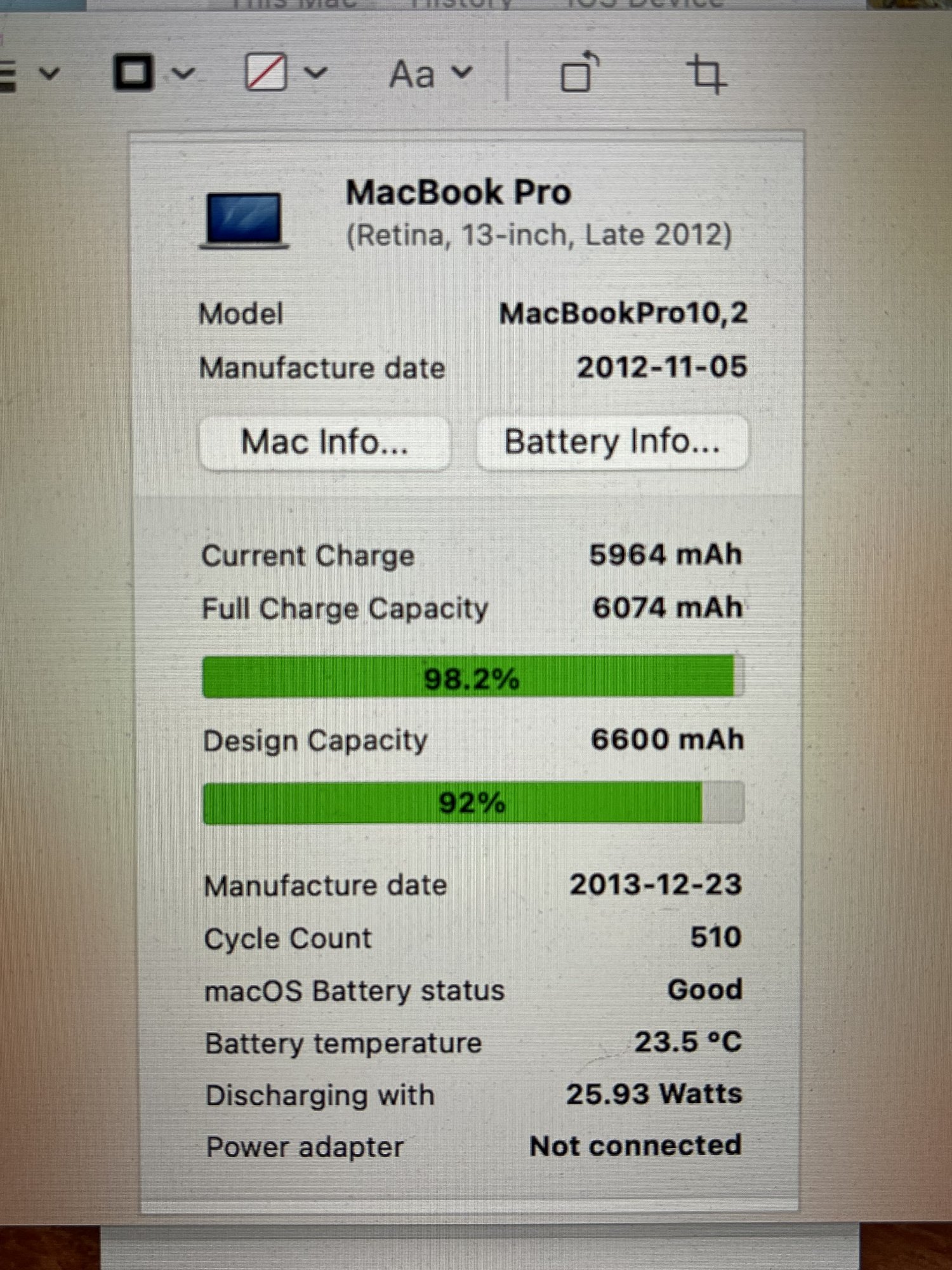

For reference. My MacBook Pro from 2012:

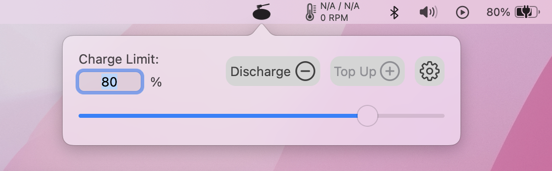

Because after 2 months my mostly plugged in M1 MBA was never held at 80% I started using AlDente Pro app to do the job. It has more control and I keep mine at 60% most of the time.

Yeh the apple one seems kinda random. Since it only sees it if you're always doing the same thing every day. But imo AlDente is better. Since you can just always cap it to say 80% (at the maximum. Best of both worlds I guess. Good capacity retention and higher capacity so it's faster to charge when you need to or when you need to use it ASAP) .
Tho if you only plug it in for days on end. Set it to 50%. And make sure to calibrate it every month or so...

Yes it does! I was at 100%, hit the discharge and let it drop to 80%. I might even buy the Pro version just to support the dev and get the calibration feature.

True. It is limited to 80% when charging but if you want to charge fully just let it go to 100% (apple and AlDente made a one time button to do that thing)
So the limit only applies when I'm charging and just technically docking it at home etc . When I know I want to go in a few hours I'll just let it go to 100%. So I don't lose battery life
