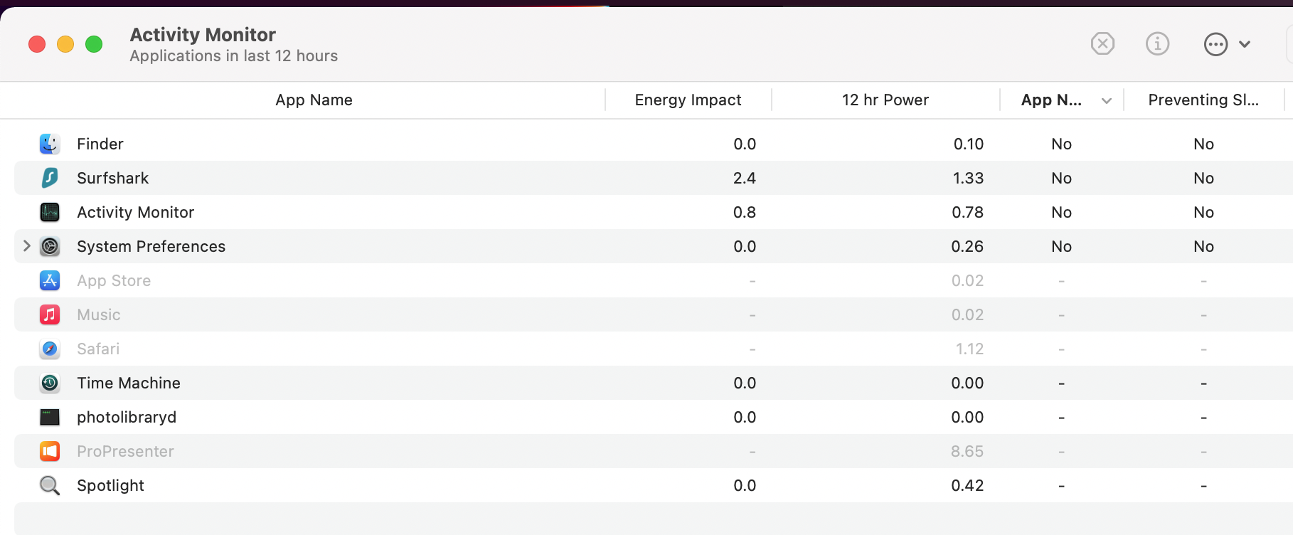

Probably indexing. The Energy tab in Activity Monitor may show where the power went.

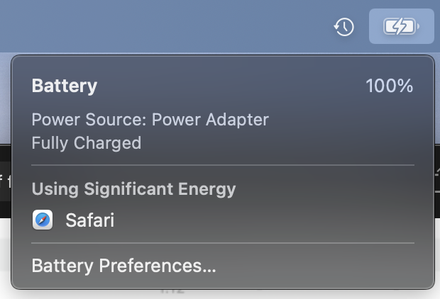

Battery usage has been normal on my base 14". But one "quirk" I've noticed is that even when the battery is fully charged, and the MagSafe light is green, the battery indicator in the menu bar still has the lighting bolt instead of the plug--which would indicate fully charged status.

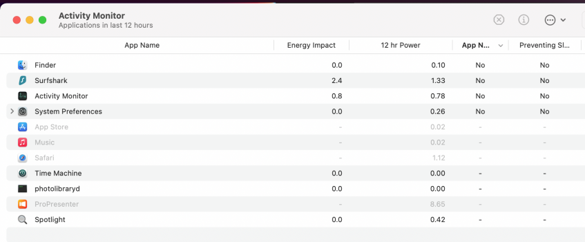

You can sort by 12 hr Power and see, who is the one using most energy. Something called ProPresenter used 8.65 (whatever the units are, lower is better), Surfshark used 1.33, and Safari used 1.12. Unless you find something with even more usage, these would be the biggest power sinks you have. Surfshark and ProPresenter are not part of macOS, macOS does not control much about them and if they use lots of power, they will discharge batteries. YOU may need to look for less power hungry tools or accept battery life.
Spotlight used only 0.42, so compare to ProPresenter it used 20x less power.
