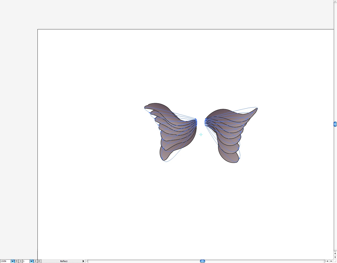

    hi all .....first time here.....don't know if anyone will be able to help....I am running illustrator cs 5 in an osx snow leopard. I am trying to design some wings....do one then reflect/ copy to get the other side matching....simple yeah.....not so....my reflect seems to be giving me a back view so to speak of the object.........its like it kindly turns it the wing over and gives me a completely different perspective....very clever but not helpful........the same exercise works fine on cs 3 so I don't know if there is a preference I have missed but have spent hours looking at all the options to no avail. I have skype so if anyone can help and wants to chat rather than type my name is josephinestar....thanks all.......Jo
  2. autacraft Guest
    #2
    Hi J
    Can you please put up a screenshot of the resulting reflection? I suspect its how you have your anchor points arranged, but wont be able to tell until ive seen it.
    thanks
    Nath

    autacraft
    hope I am replying correctly.....I am adding a shot.....I have discovered that if I don't put a twist in the original wing I don't have any issues. Unfortunately in the original exercise I am copying from she put the twist in and still got a perfect mirror image. buttefly wing snapshot.jpg

    Looking at your screenshot it appears that you have applied a warp effect to the wing. If you 'expand appearance' and try reflecting again I think it should work. Save a copy of the original wing so that you can adjust the effect if needed.
    Hope that helps.
  8. tobefirst macrumors 68040
    tobefirst
    Joined:
    Jan 24, 2005
    Location:
    St. Louis, MO
    #8
    This should be the answer. A coworker of mine was having the same issue. He had used a brush applied as a stroke to a line and trying to reflect it was causing issues. He needed to expand the appearance of the brush stroke first.
