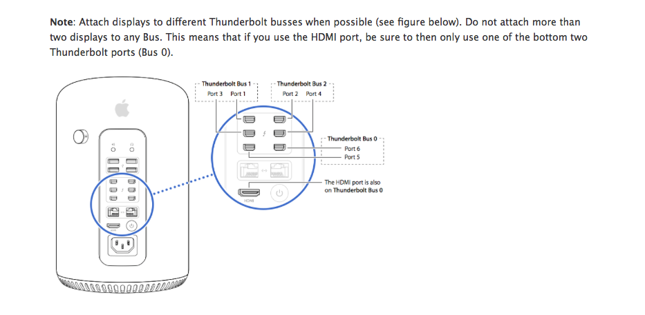

The HDMI port on the MacPro 6,1 shares Thunderbolt bus 0 with Thunderbolt ports 5 and 6.
