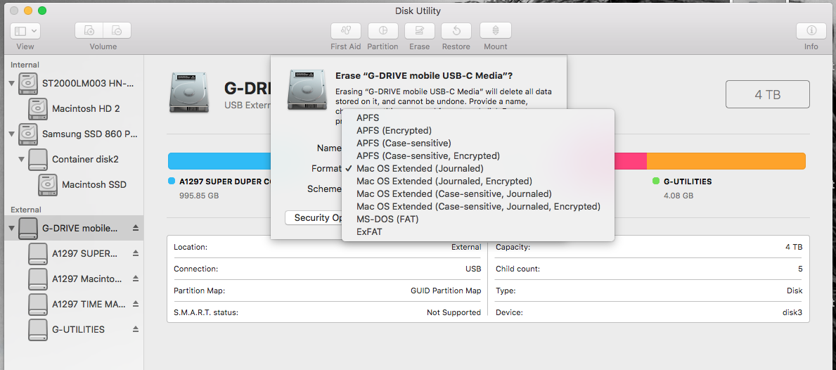

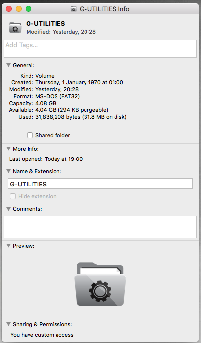

Thanks for the input so far & please forgive the number of screen-shots posted below - I wanted to provide as much info as I could since I am not technically savvy.
1) The Brand New Hard Drive used for the very first time to Copy/Paste - it was factory formatted to Mac so I used it like that:

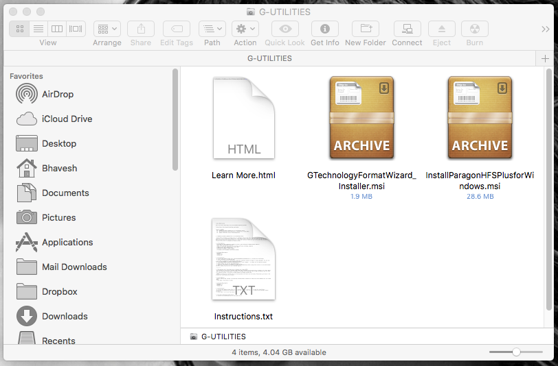

2) The "Extra" Folder (& contents) from the HDD that loads on to the Desktop when HDD is connected named "G-Utilities" (it is formatted as MS Dos/Fat32):
I do not know what this folder is or if the contents inside were required or necessary so left it alone in case removing it adversely affected things since it was factory installed?
Should I have run the "G-Technology Format Wizard Installer.msi" inside it?
What about the "InstallParaginHFSPlusforWindows.msi"?

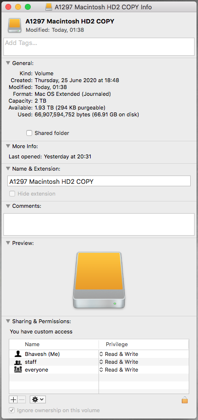

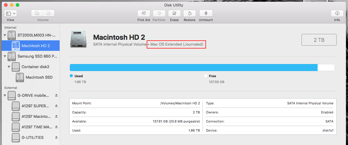

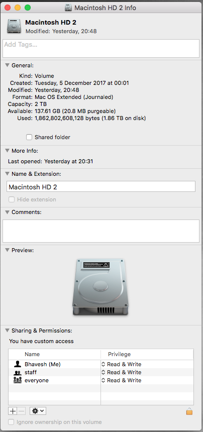

3) Get Info & Disk Utility showing format of 2nd Internal HDD in MBP:
4) Get Info & Disk Utility showing format of New 4TB HDD:
5) Formatting Options available (on Internal 2nd HDD or External HDD) - Only case "sensitive" options available - there are no case "insensitive" options?
I hope the above explains things better than I have been able to & shed some light as to any cues as to what might be causing the error-36's!
More info on next post!
Many Thanks!

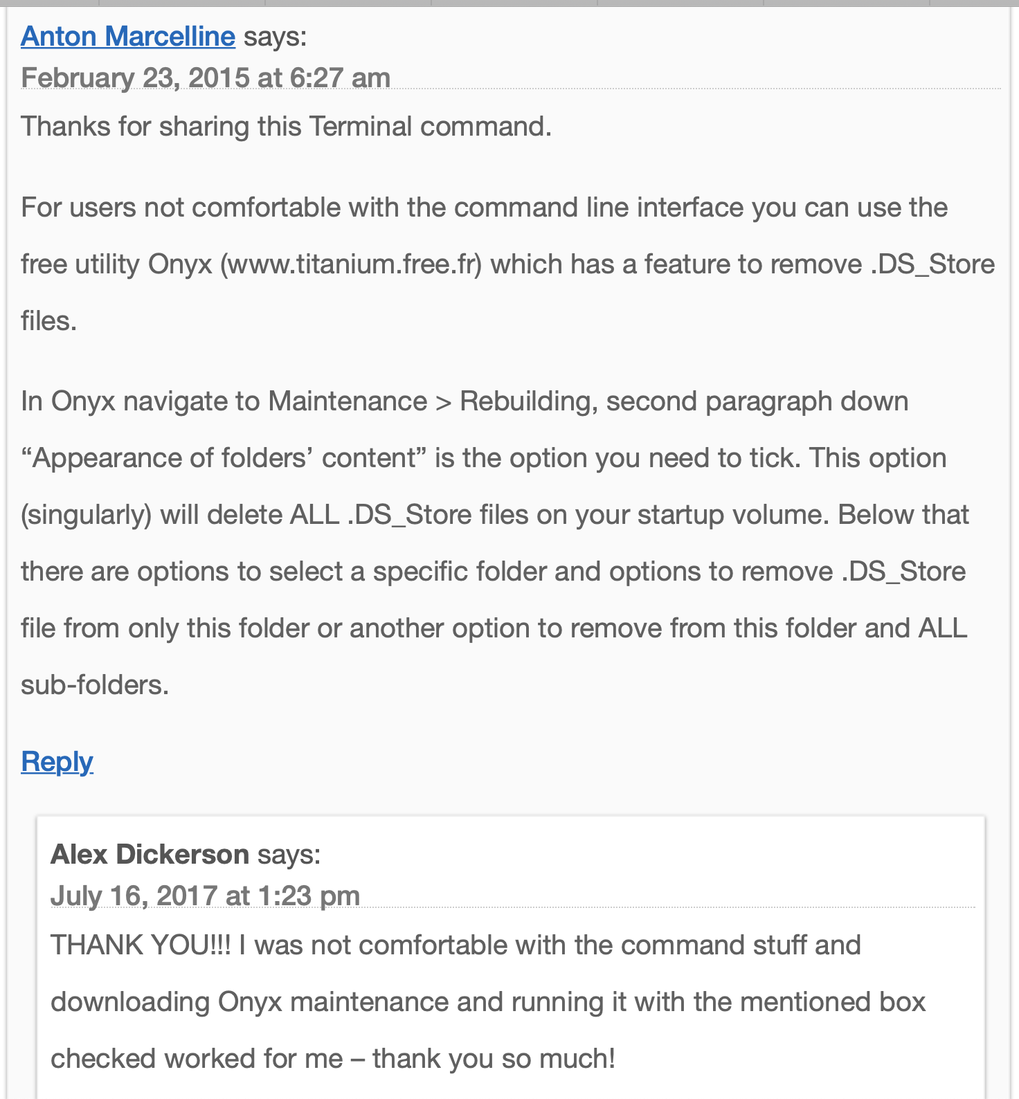

Hi Again All,

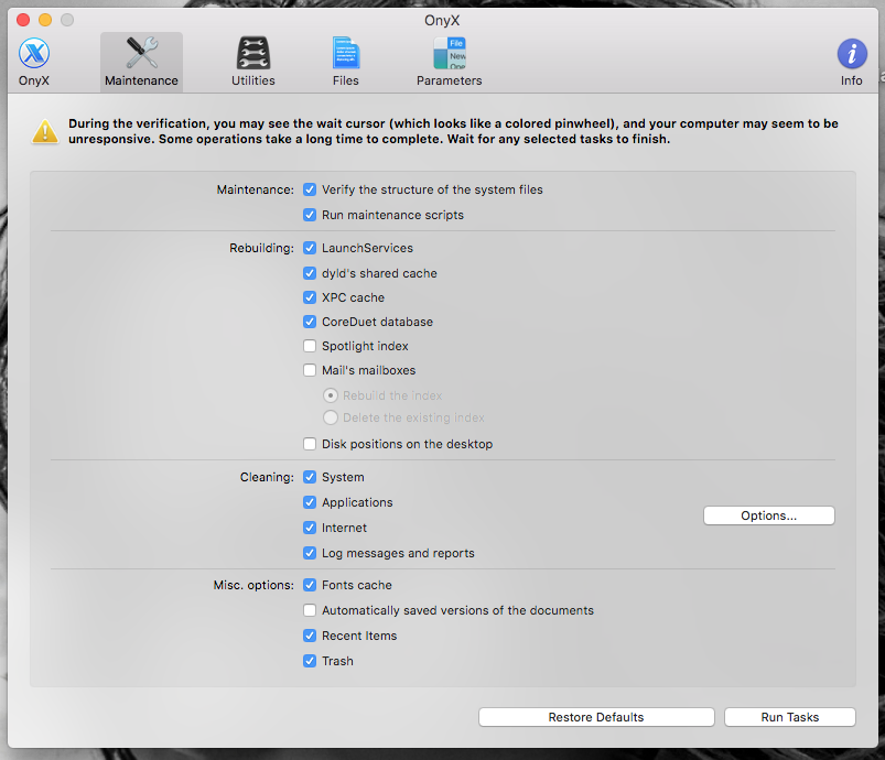

I also referenced a detailed thread from another site which gave some options to resolve but none sadly worked. Another user who also experienced the same stated they were able to resolve by using "Onyx" & gave instructions by going into the maintenance pane & selecting certain options but my version on Onyx on High Sierra does not seem have have them so I was unable to try out:
1) Instructions given to remove error-36 issues from another user using Onyx:
2) When attempting to do the above was unable since the options/selections required are not there on my version on Onyx (MBP running High Sierra):
Can my version of Onyx still sort the issues out & if so, what exactly must I do?
This is the point where I contacted you good folks over here! It seems that these error-36 issues have stumped far greater minds than mine in the past so I had no chance to resolve by myself!
Many Thanks!

1- format the HDD("G-Drive mobile") to Mac OS extended(journaled)
2- I seriously doubt this folder contains anything that the Mac OS lacks/you need so : format =delete=ignore it
looks like windows crap anyway;)
3-i recommend default permission settings for HD 2 , format is ok already
4-there are 4 partitions (why?), format to 1 clean Mac OS extended(journaled) by doing point 1.
5-see point 4, case Insensitive = when not mentioned case sensitive ( joke by fishrrman).
I don't think Onyx will solve the issue error-36.
It can be a useful (and risky) app, but not for this kind of problems.

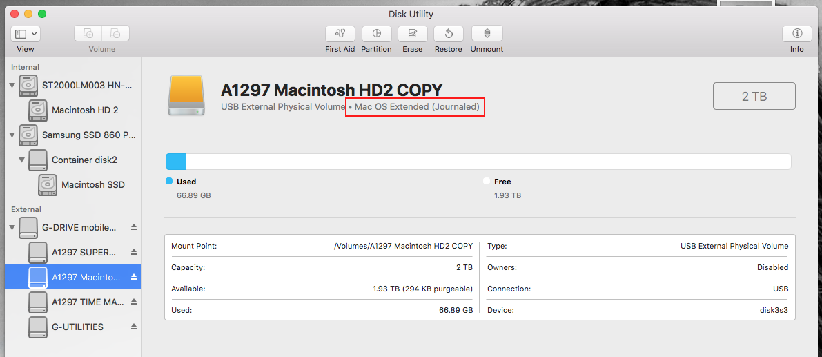

Update - I wiped & reformatted the new external HDD as instructed via disk utility (no more G-Utilities Folder). Turned off File Sharing & set Permissions as also instructed. Finally, ran a First Aid & all was fine with the drive - no partitions - just a single 4TB volume.
Tried to Copy/Paste again from 2nd Internal HDD & low& behold, within a short time, that darned freaking error-36 popped up again.
Beyond frustrated now - so fed up!

  • Moving Folders & Files to the Desktop & then copy/pasting.
  • Creating new Folders & transferring all contents from from existing Folders to new ones with a different name.
  • Turning energy usage to max.
  • Moving the folders/files to trash & moving them back again.
  • Restarting Finder.
  • File Permissions set to Sharing.
  • Setting Read/Write privileges.
I tried all of the above but no joy sadly - I get error-36 messages each time.

Hi!
Wow, that was a very useful post & most helpful - many thanks indeed!
After reformatting the external HDD as instructed & also following the other procedures mentioned which sadly did not work - out of desperation, I reformatted it again but this time in ExFat in the hope that this might do the trick as I read that transferring files between Mac & Windows etc can sometimes cause these errors. I was hoping for too much it seems as like clockwork, they still appeared!
I have SuperDuper (like CCC) but it does not give any detailed info on file transfers or errors - you just get a message that the Back Up failed - this can be infuriating if such happens when one might have been waiting many hours for the back up to complete or if it happens right near the end of a large transfer/back up.

I sure hope you get this figured out. I use the same G-Tech drive for my MBP. Worked fine right out of the box for Time Machine & SuperDuper clones. That's all I use it for.
I get the same G-Utilities folder displayed when the drive is connected and I have external disks selected in Finder Preferences. I never worried about it.
