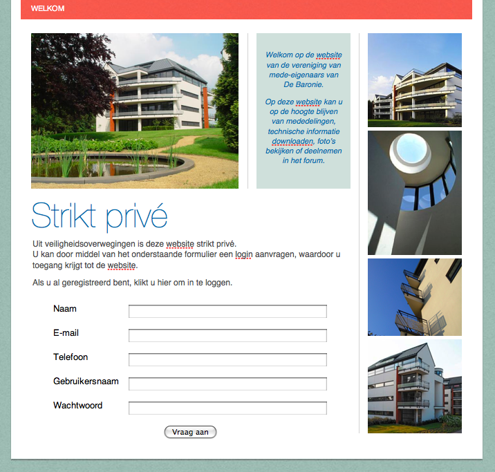

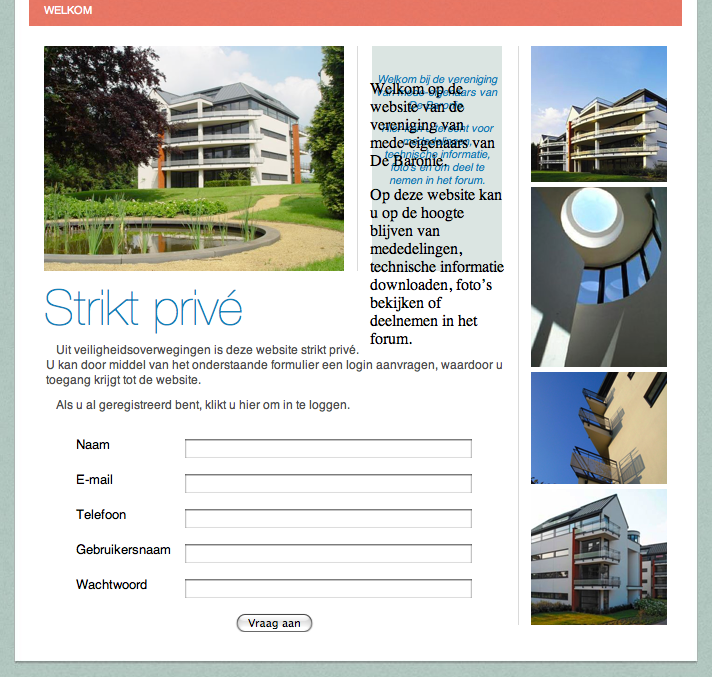

Here are 2 screenshots. The first is in iWeb, the second in Safari.
The site works fine in Firefox (except for 1 font, but I can live with that)
I published the website in a local folder.
Ouch, I'm sorry, here they are.

The text looks correct underneath the repeated text. Was that a text box you created or part of a template?
Just to be sure... you reposted after deleting the text area?
It appears the text area was still there, but without any text. Deleted it now and the problem's fixed. (that doesn't justify the text still being there in Safari, when the text area was empty though)
