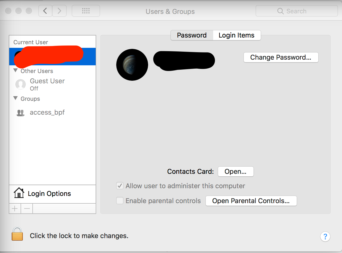

Replicated this on macOS 10.13.1
I followed the instructions and set a root password.
But now I have created some sort of group, anyone have any idea why this has occured?
