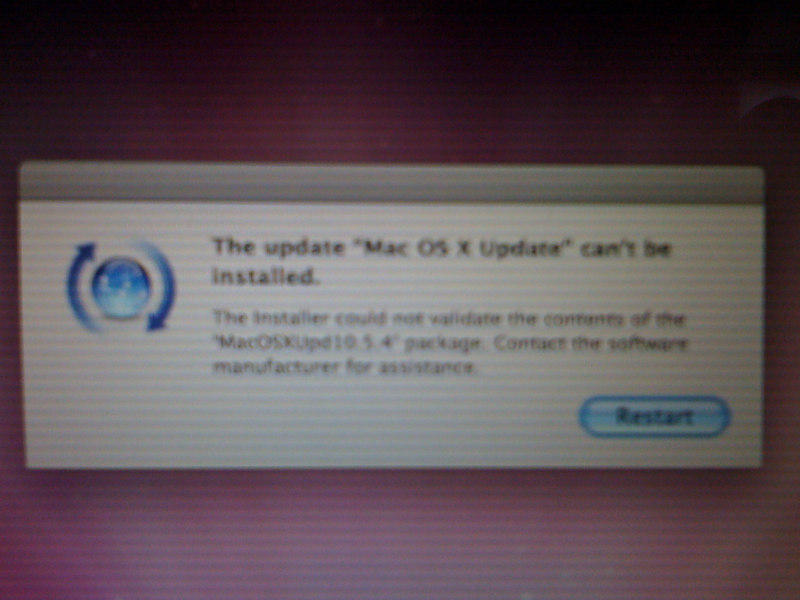

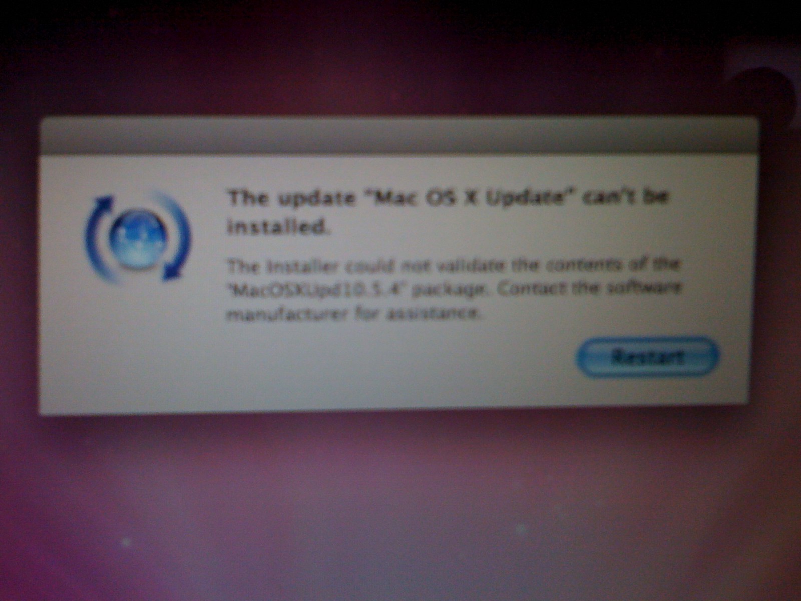

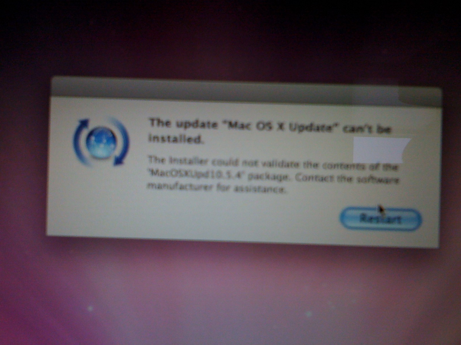

earlier today i noticed their was some striping on my screen.. i tried a reset but that seemed to make it all worse. my apps are always quitting, and i am always reporting it to apple.
i thought installing the new update for leopard would help, but the update actually failed, and i got a popup saying "update cannot be installed, contact software creator"
help!
edit: the striping isnt fixed on the screen, it only appears on a couple images etc.
edit: Read post #7 for updated info
anyone? i have to use the downstairs computer because no apps will stay open long enough without quitting...
edit: here is the message i get when trying to install osx

I would do the following. You may have some corrupted caches, disk file system corruption, etc.
1. SMC reset
2. PRAM reset
3. Safe Boot
I would also download the combo updater (10.5.4) instead of using the delta updater that Software Update downloads.
When it comes to OS updates, always do it in Safe Boot mode and use the combo updaters. This will resolve a lot of issues.

THANK YOU! a simple pram reset stopped the screen striping and the applications quitting, and the combo installer from apple.com did the trick!
