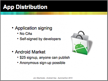

3) The vetting process for app submission to the Android Market is much less strict than the equivalent for iOS.
http://jon.oberheide.org/files/summercon10-androidhax-jonoberheide.pdf

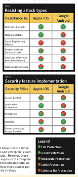

4) These factors contributed to the following comparison between Android and iOS.
http://www.symantec.com/content/en/us/about/media/pdfs/symc_mobile_device_security_june2011.pdf
