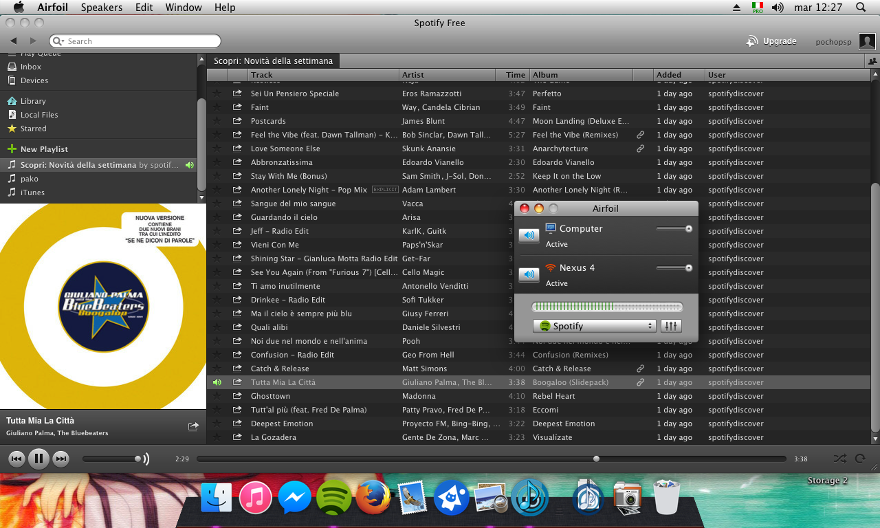

@charlieroberts Unfortunately i do not have a bluetooth speaker, but you gave me a good idea, and I found a wonderful app that makes what you said possible!!
Here is Airfoil from Roguea Amoeba, available for powerpc, it works with android phones, iphones and wifi speakers!! (the only problem is that after 10 minutes a noise make your music unbearable to listen, unless you pay for the app, but you can avoid this by restarting the app)

Here is a screen of the app running with Spotify with the music playing on my PowerMac speaker along with my Nexus 4 speaker:
