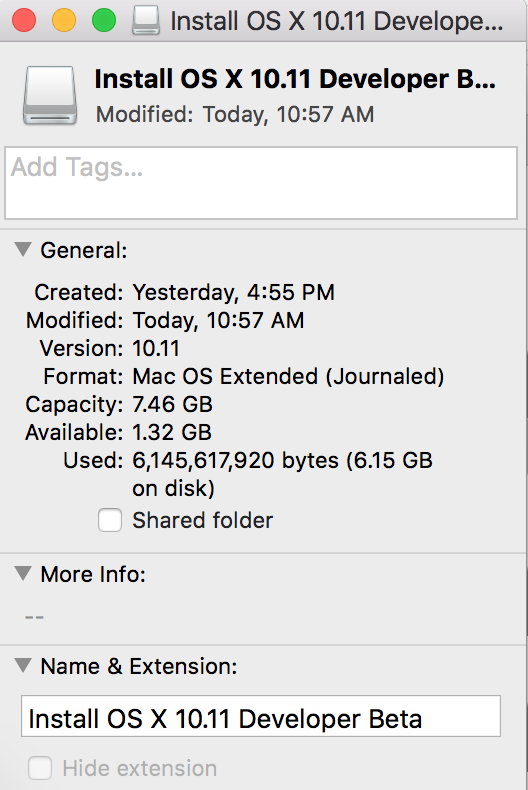

10.10.3 USB drive takes about 6 GB, leaving almost 2 GB free.... 10.11 DP1 USB drive takes about 7.5 GB, leaving about 1.4 GB free.

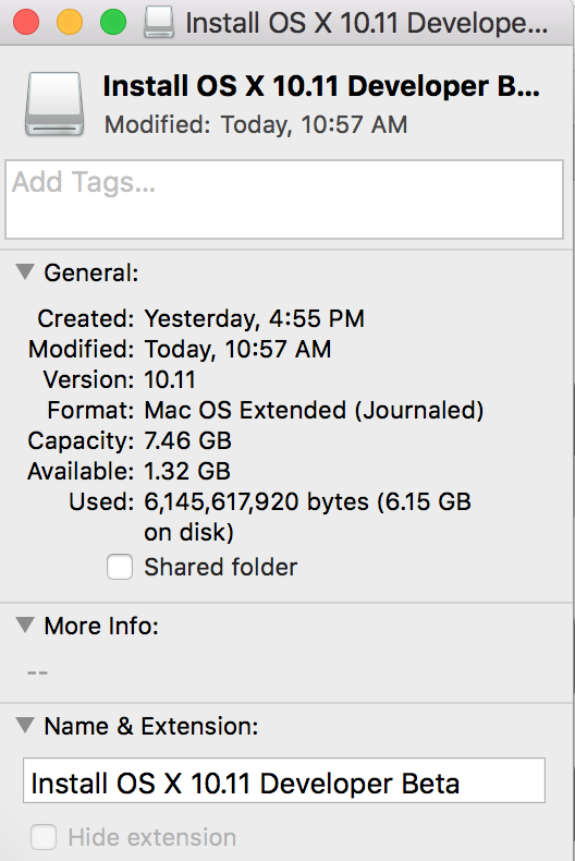

Slight error there. On an 8gb drive, you should see the following:
total capacity - 7.46GB
available - 1.32GB
used - 6.15GB
Assuming that you rounded up for simplicity, it looks like you accidentally switched used with total capacity.

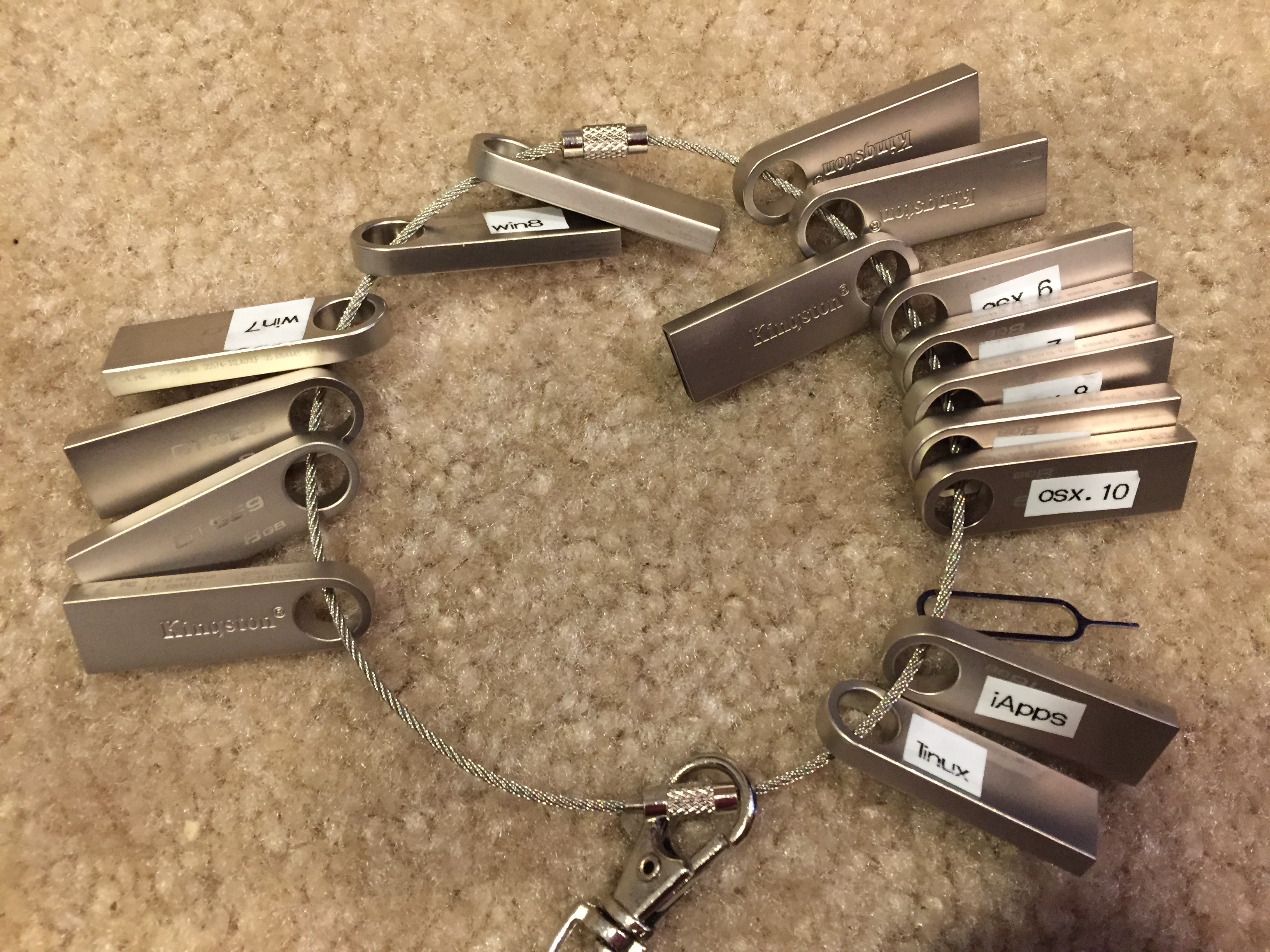

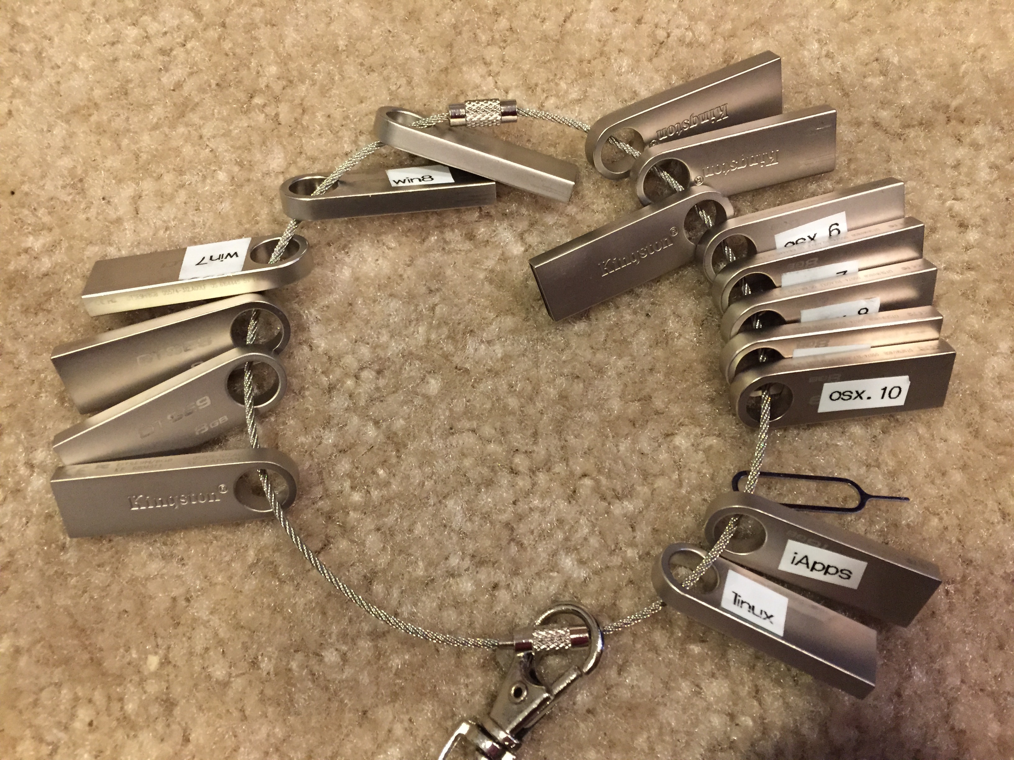

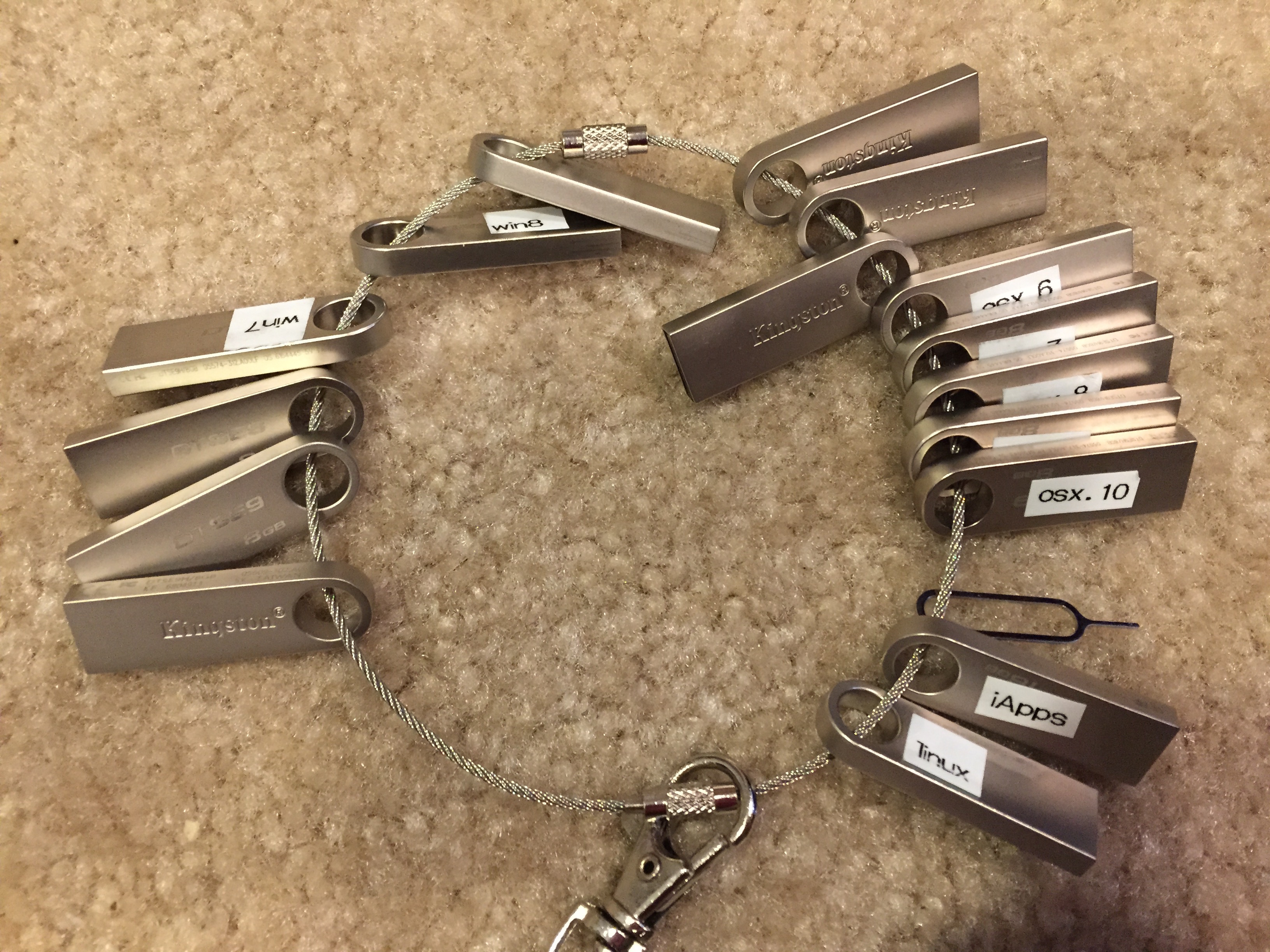

I have a tech keychain. Basically I purchase a whole bunch of usb drives and have them all on two Cable Key Ring chain linked together. On it I have every version of OS X from 10.6 - 10.11; Windows XP - 10; and the latest version of Ubuntu. Every OS fits nicely on an its own 8GB drive. I do have a couple of 16GB with apps. For example on the one for OS X, it has iLife 11, iWork 09, and Carbon Copy Cloner. Ever since I put all this on the keychain, it has really simplified setting up computers without having to spend a whole bunch of time looking for disks or remaking a CD/DVD/Bootable USB.
I don't think 16GB is really needed. If that is what you have and want to use, no worries. But without opening the whole can of worms, I would HIGHLY doubt the OS would grown more then a couple hundred MB.... let alone 1.3GB.
