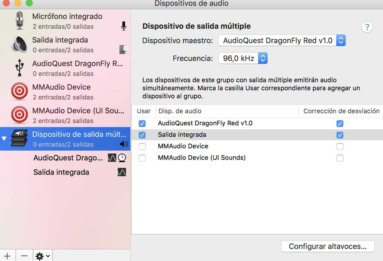

Yes.
Now hearing internal+external at same time! (I'm sorry the snap is in Spanish... But I suppose you can find the way to do it. Ask if you need it). That usb sound-out interface you mention should work.🙂
