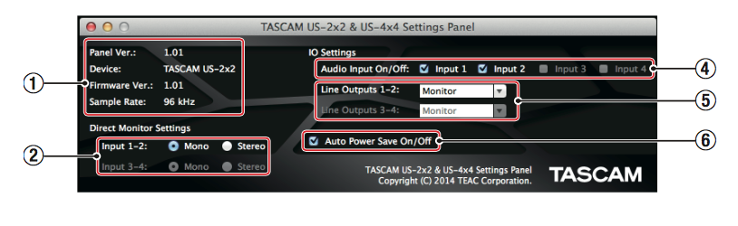

The software for the tascam should have added a settings panel to your system preferences and you can switch between mono and stereo there.
If you don't have it, you can download it here: http://tascam.com/product/us-2x2/downloads/

The software: Yeah, I downloaded it and its misleading. If you read the text above it, it only changes the monitoring session. There isn't a way I see to make it stereo or mono in the Mac OS itself. Toggling that button just changes the feedback in the headphones, not the output.

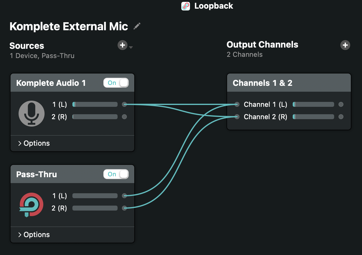

I'm using Loopback to create a Virtual Device to output my mono signal (left channel) to stereo.
At $99, it's a costly solution, but we live in Hell World, so ...
