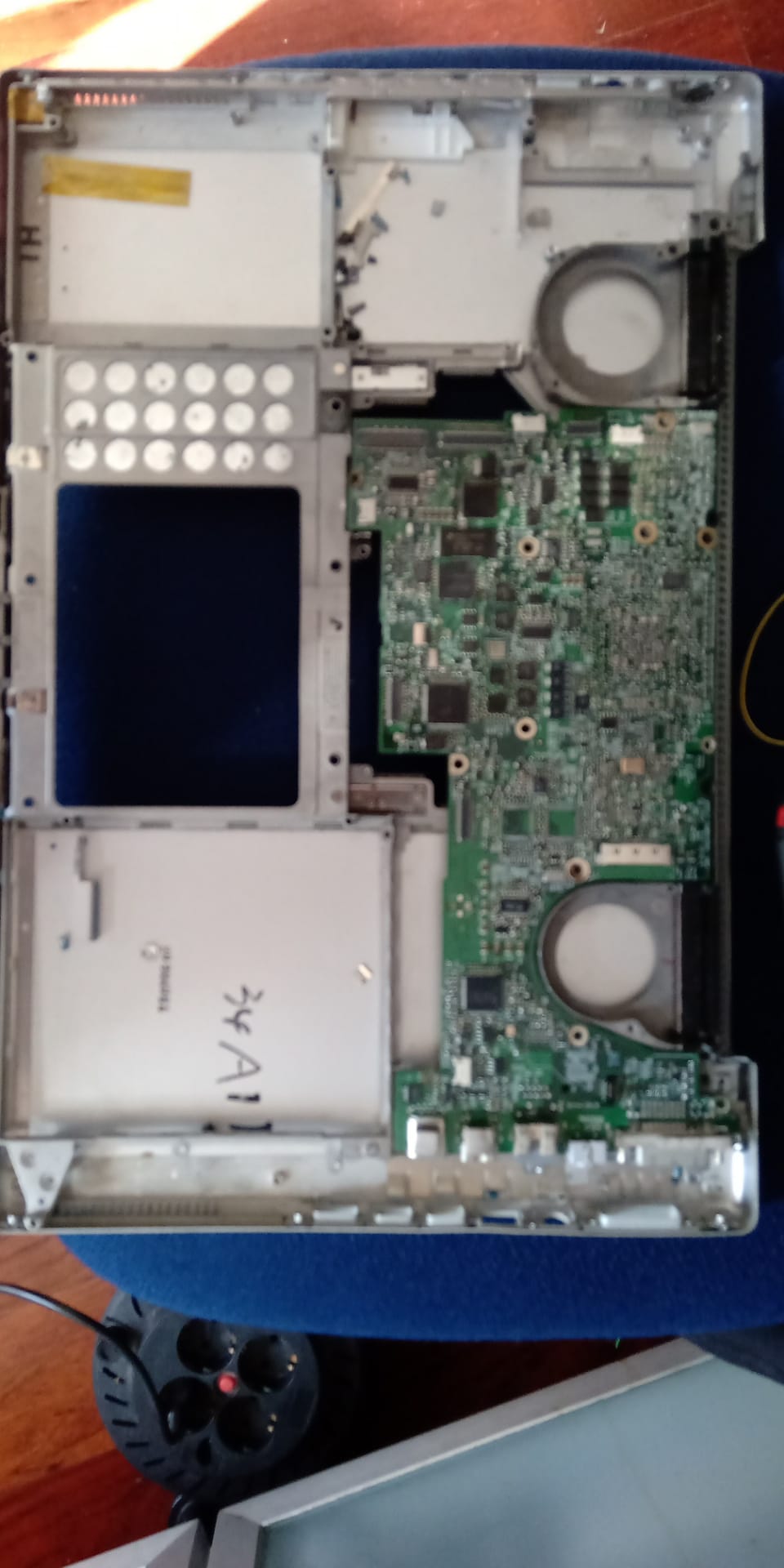

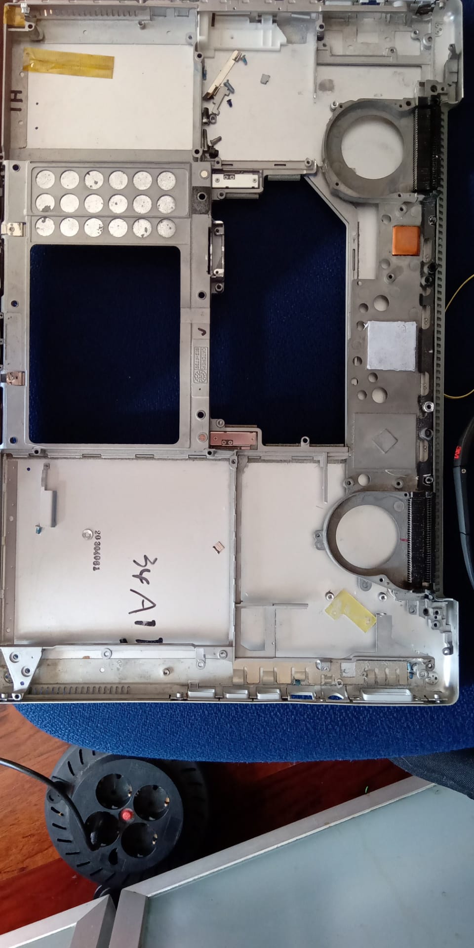

Well I want to use all PowerPC :-D
From case to components :)
Best regards.
voidRunner

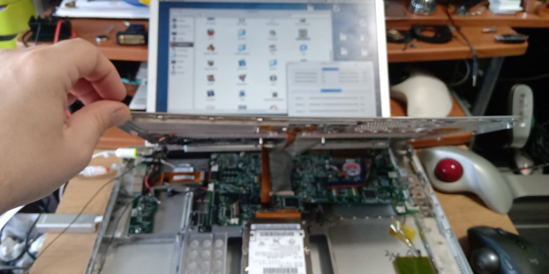

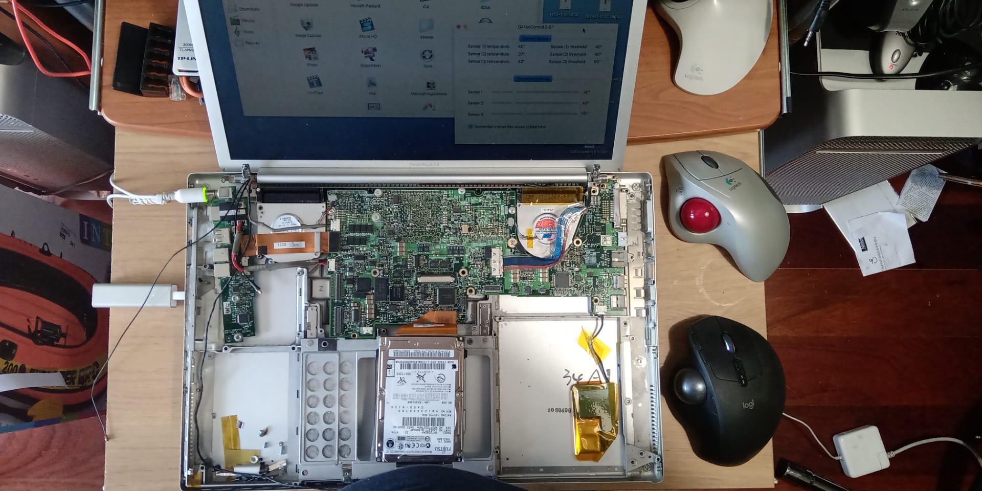

Hi guys,
A quick update on my endeavours :D
It's looking like this ;-)
Right now I'm testing with a PBG4 1.25Ghz with 256MBRAM running tiger ( no sound, wireless, bluetooth yet )
The logic board is "screwed" in place with the necessary cuts done on the case and
logic board support/heatsink/heatpipe.
IT'S ALIVE :D
Best regards,
voidRunner

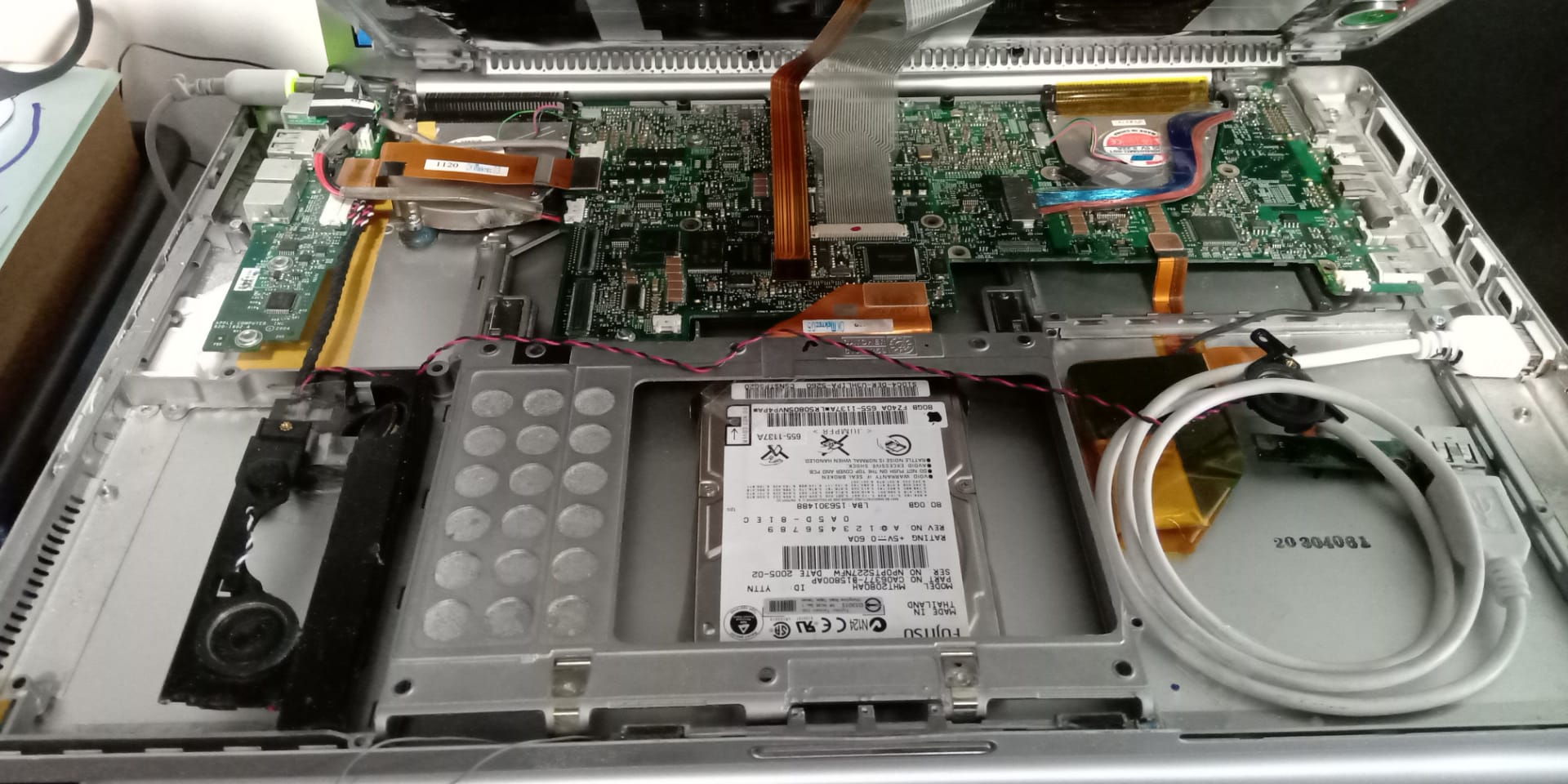

Hi all,
Quick update.
0 - Better logic board fixing to case. Now LCD weight is properly supported :D
1 - Sound is connected and working but needs work ( sound bar too high for pb 17" case height )
2 - Wireless connected ( PB 17" airport express card )
3 - 1 usb port external accessible ( right side using a unifying receiver from logitech ) need
to find a smaller usb extender cable ;-)
Best regards,
voidRunner

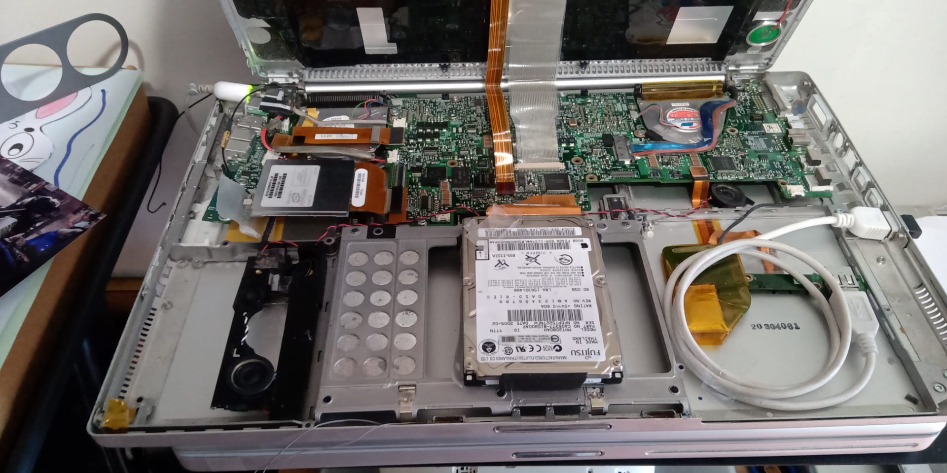

Hi guys,
So some good news and some bad :( .
So for the bad I fried my pub's logic board hd controller.
The good news is I still have a logic board to continue this ad it is already
in the pb 17" case.
I've also made some improvements:
1 - I made a cut so the usb extende cable sits better on the case ( it was a bit tilted down on the outside )
2 - The HD is now sits inside the case inside the battery compartment ( a horizontal cut was made to pass the
HD cable )
A shot below :D
Best regards,
voidRunner
