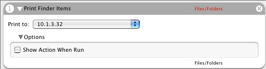

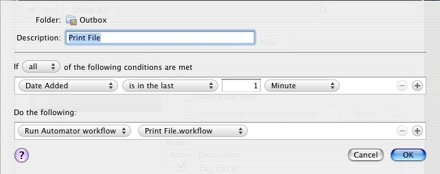

Here's one way to do it, I just tried it and it works. Uses a combination of Hazel and Automator (you may be able to do it with a folder action but I like Hazel).
Set a Hazel rule for the folder the pictures will appear in to trigger an automator workflow. The automator workflow just contains one action. Here are some screen grabs of the Hazel and Automator setups...
Hope this helps, it's pretty basic in how it prints, but maybe will get you closer to what you want

That is real clever. Is there a way to print using correct paper profiles or maybe 4 thumbnails on a sheet of 4 x 6 using this method.
