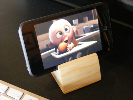

What do you think one is worth? I'll mass produce a 100 or so in cherry or walnut if I sense a desire that matches the time and expense of making them. The Touch is 8mm thick, so I used a 21/64ths drill bit to start the grove then my bandsaw to finish the angle cuts. Tell me how thick the iPhone is and I'll make a prototype to show.
4D
If anyone can affirm that an iPhone is 11.6mm, making a nice little wood stand like the pine one I showed earlier is pretty easy to do. I don't have an iPhone, and won't be getting one (no service in my area). A 15/32 drill bit will work fine for establishing the width of the slot. Drill press is used to drill a hole straight and true through the wood block. The bandsaw is used to cut angled parallel sides down to the hole. A file or sandpaper wrapped around a thin wood block helps smooth the bandsaw cuts and square the front edge of the slot for the front edge of the iphone. Width is just the same width as the screen (narrow) dimension. Finish with tongue oil or danish oil.

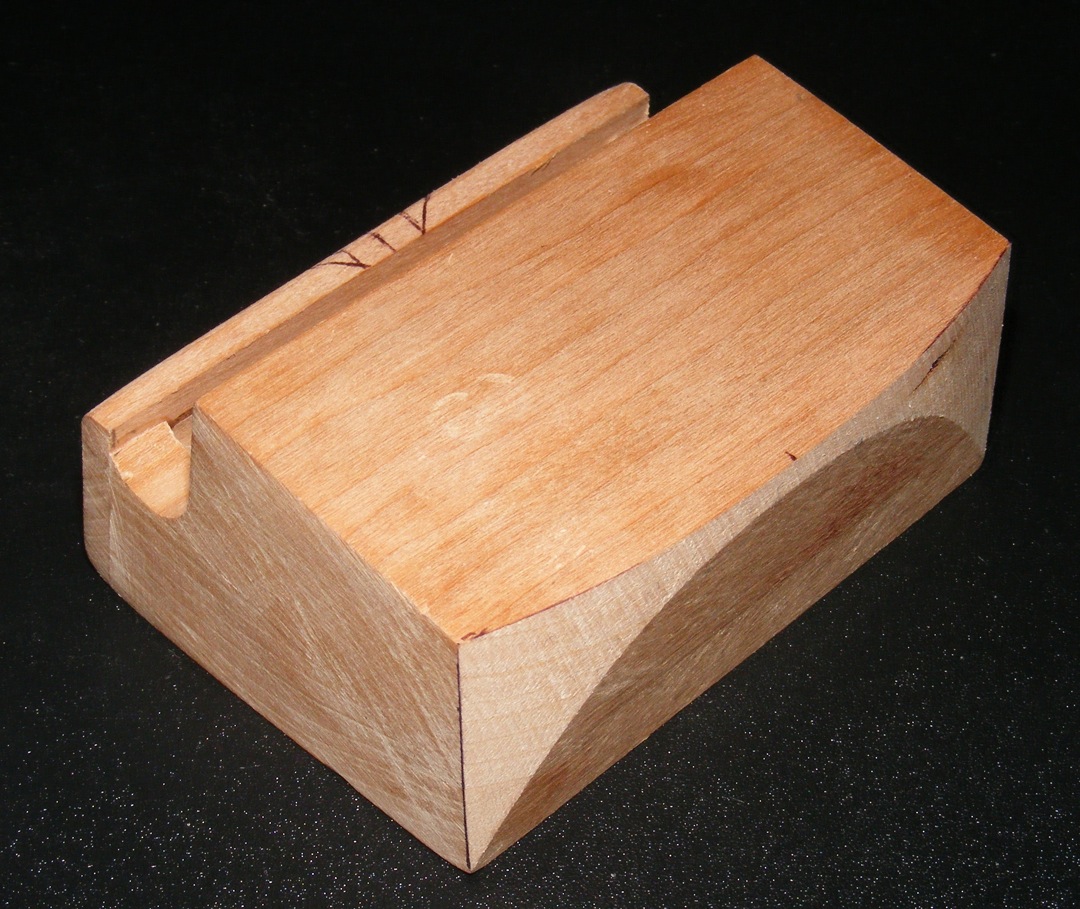

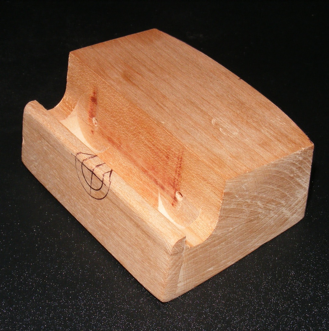

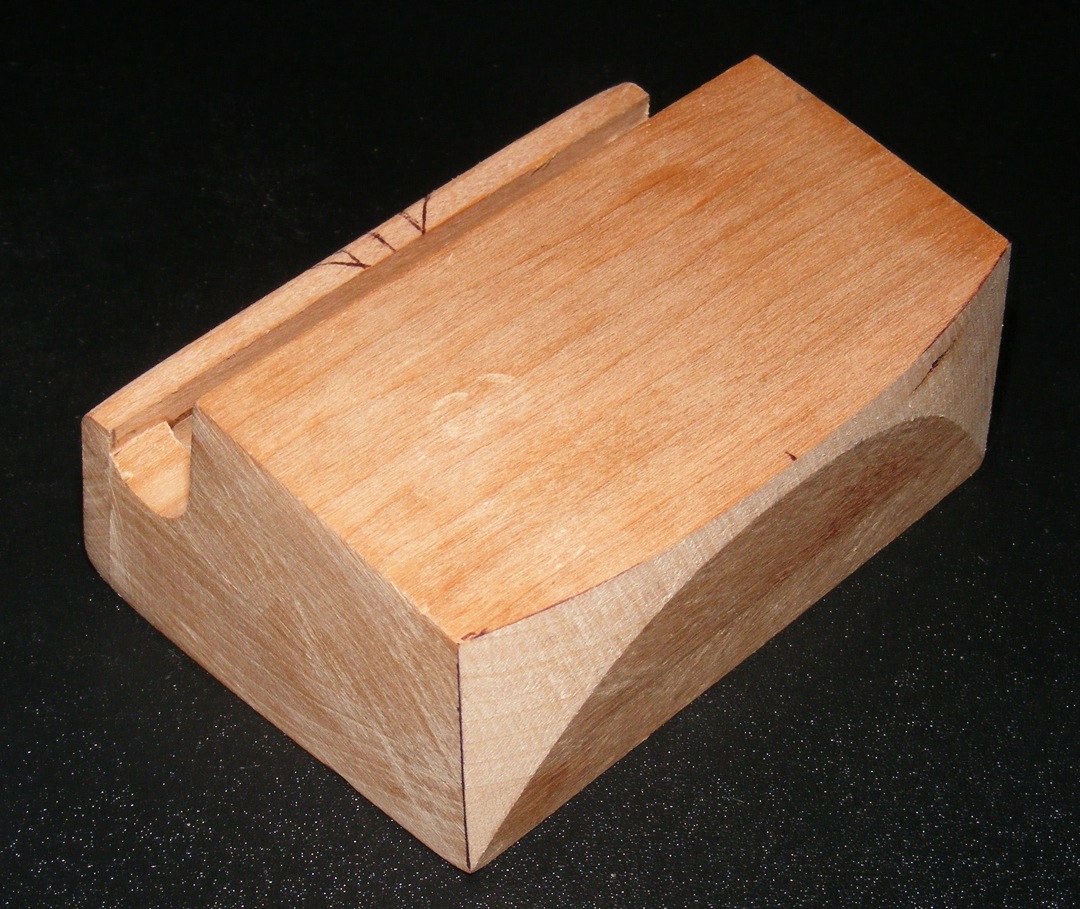

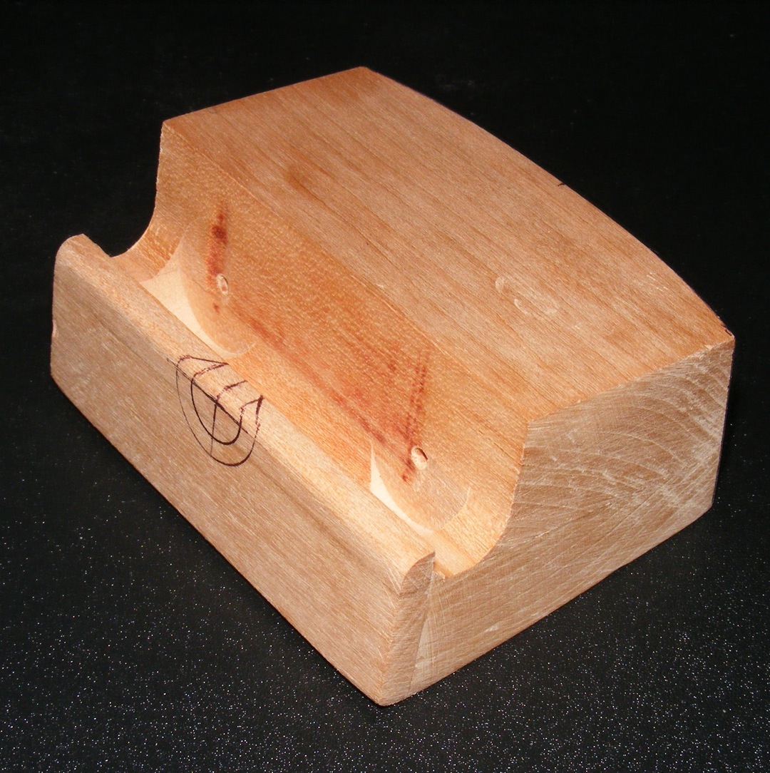

Here are two photos of the Cherry stand, still raw wood. I'm playing with the profile a bit. Tell me what you think. The drawn detail on the front is for a potential cut that would give you access to the home button when the Touch/iPhone was vertical. I may or may not drill it out, but it means you'll have to pick the device up to hit the home button if I don't.
