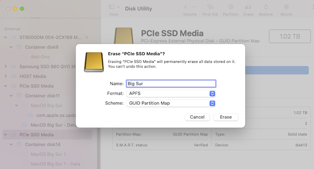

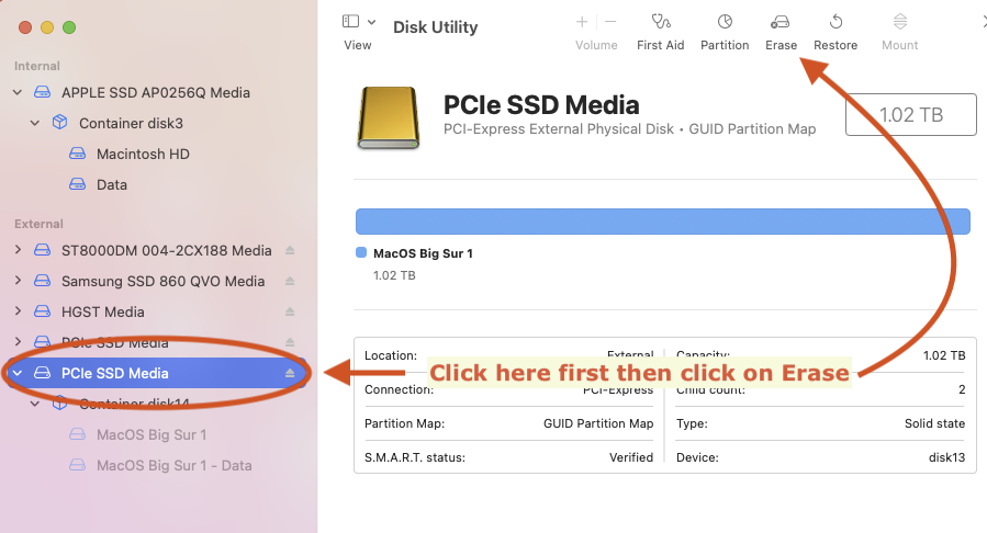

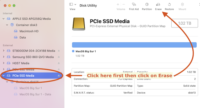

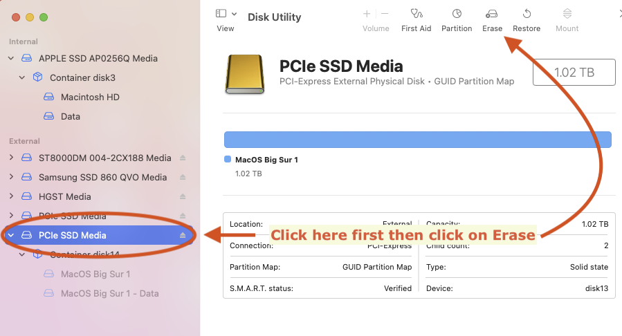

The first thing that you’ll need to do is to format your hard drive. With Big Sur this is a little bit trickier than with other versions of macOS. Please follow this step exactly as outlined because if you don’t complete this step correctly, then the entire procedure will fail. Of the 3 steps, this is one of the most important!
First things first, you’ll need to do your hard drive formatting from the M1, and not from an intel Mac. You will not need to go into Recovery to format (that works best for internal disks, not external). Since you will be doing this procedure from the desktop, it is more straight forward to simply perform this step from Disk Utility.
Go to Applications > Utilities folder > Disk Utility. Click the “View” button at the top of Disk Utilities and then choose “Show All Devices”. Find the Volume that you wish to format and click on the top level of it, then click on Erase:

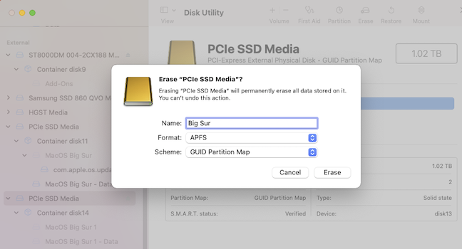

A new window will popup:
For “Name” type in what you wish to name your hard drive.
For “Format” you’ll need to choose “APFS”.
For “Scheme” you’ll need to choose “GUID Partition Map” and then click on the Erase button.

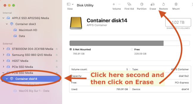

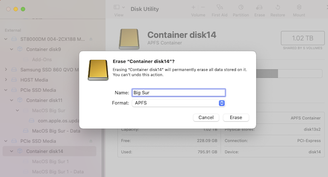

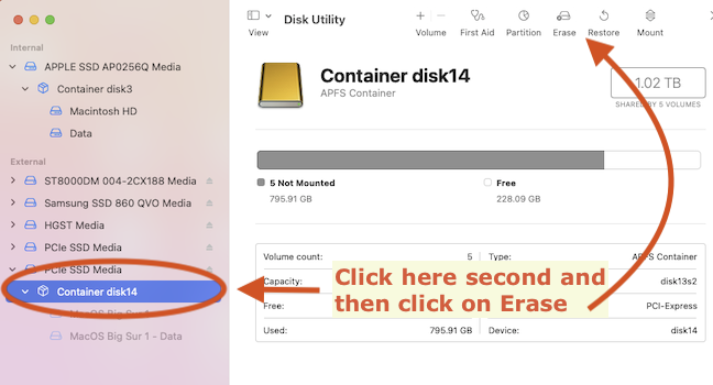

Your hard drive is now formatted for your M1, however I always like to take an extra step just to make sure that the container is properly formatted. You can skip this step if you wish.
Click on the next level right below the top level.

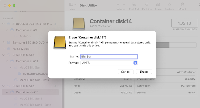

It will say “Container” with the number of your Volume. With the Container level highlighted, click on the Erase button on the top menu. A popup will appear:
For “Format” choose “APFS” and then click on the Erase button.
Step one is now completed. You can close Disk Utility. You can now move onto step two.

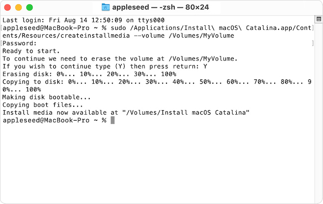

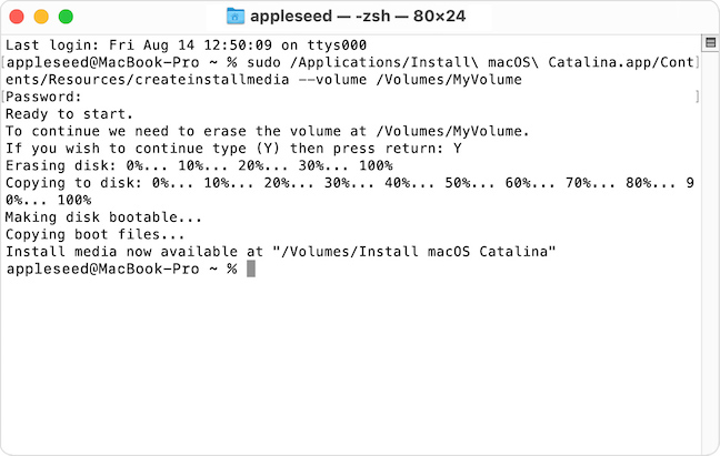

With the MyVolume USB flash drive plugged into your M1, open Terminal, which is in the Utilities folder of your Applications folder.
Copy and paste in the following command into Terminal;
Code:
sudo /Applications/Install\ macOS\ Big\ Sur.app/Contents/Resources/createinstallmedia --volume /Volumes/MyVolume
After pasting in the command press Return. When prompted, type in your administrator password and press the Return key again. You probably won’t see your password as you type it in. This is normal and is a security feature.
When prompted, type Y to confirm that you want to erase the volume, then press Return. Terminal will show you the progress as the USB flash drive is being erased.
After the USB flash drive has been erased, you will see an alert that Terminal would like to access files on a removable volume. Click OK to allow the copy process to proceed.
When Terminal says “Install media now available at…” the process has completed and the installer will be renamed “Install macOS Big Sur”.
Step two has now been completed, and you can now close down Terminal.

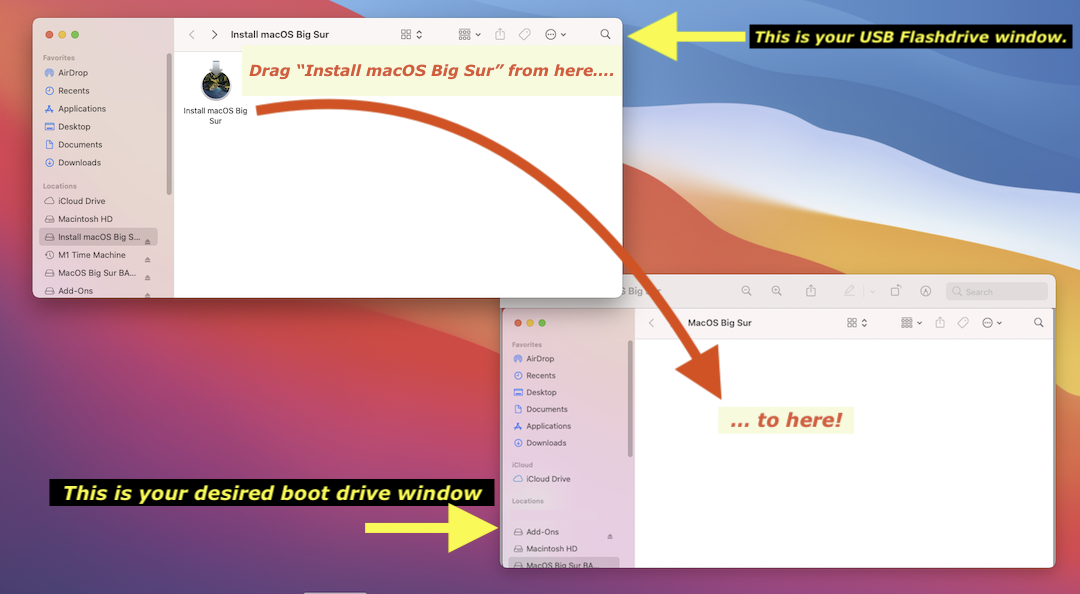

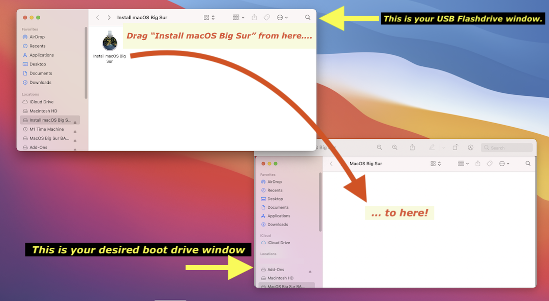

This step is where everything comes together. Click on the (formatted) hard drive that you wish to install macOS Big Sur into to open it up. Next, click on the USB flash drive to open it up.
Click on theInstall macOS Big Sur’ installer and drag it to the hard drive where you wish to install Big Sur. You can also copy and paste it in your hard drive if that is easier for you.
Once it has copied over, double click on it and watch the magic happen. The entire process usually takes around 20 minutes to install. Long gone are the days when you would have to wait over two hours to install Big Sur. Follow the on screen prompts to complete the process. I do not recommend that you use your M1 for anything else while the install process is being completed.
Code:
Step 3 of 3;
Placing the converted installer into your Volume of choice:

I am a little lost on your step 3 - can you also add photos for it?
My pleasure Leon! I'm at work right now but as soon as I get home I'll add some pics for this step.
Basically you're just copying the converted installer over to the hard drive that you want to use as the external drive.
Thanks. Thats where I am lost what to copy exactly in step 3.
Sorry, feeling stupid without the pic.. and am generally new to Mac
