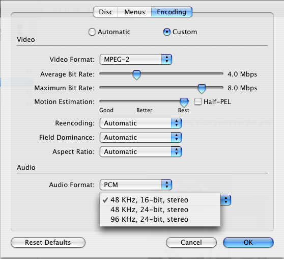

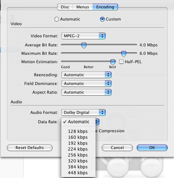

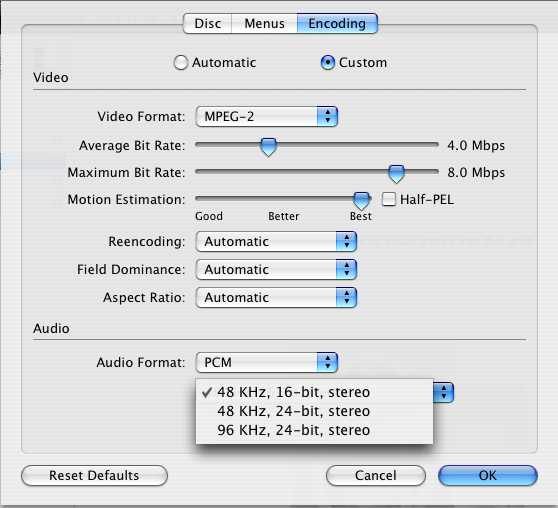

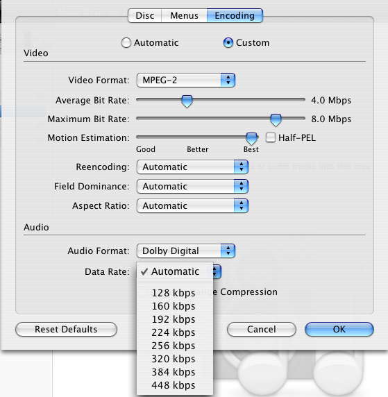

A lot of my collection is high quality MP3 files because I was an emusic subscriber for years. My purchased CD's have been ripped to lossless flac files.
I really like the idea of putting a wack of music on a DVD, but I don't want to waste my free time if its going to degrade the sound. Toast 9 does the conversion when you burn, so what settings would I use in Toast 9 to get the best SQ if this is attainable.
Pcm 48, 16
You really don't want to waste more bits on the problem than PCM 48khz, 16 bit. A bit like a 5 megapixel camera on a phone, you'd just be capturing the limitations of the media in exquisite detail if you went further than this. The source material is almost always 44.1Khz/ 16 bit, so you're not going to get better than that. As others have said, there will be no loss of quality with PCM conversion - an MP3 is a series of time and frequency-sliced descriptive equations of wave-forms that cannot be "directly" played; it is always "translated" to PCM in the player just before you hear it. All you are doing is capturing that translation for your DVD. The output will be identical. All the audio degradation happened long before conversion back to PCM.
Thanks SigmundFraud for the detailed explanation, I will use the PCM 48khz, 16 bit setting in Toast 9.
