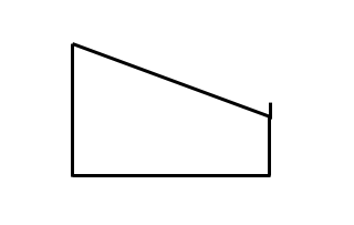

The easiest type to make is to use 3/4" boards, make two sides with about a 30º angle cut on the top, flat on bottom.
Attach on top of those another 3/4" board wide and long enough to accommodate the MBP on all sides with a little bit of a margin, then attach a thin wooden strip to the front, running the length of the front and rising about 1" up from the platform. Then drill a pattern in the computer surface for airflow. You can also attach fans underneath the surface for extra airflow.
You wind up with something that looks like my (very technical 😉) attachment.

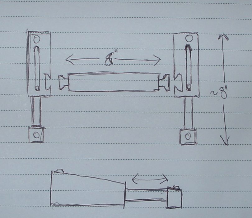

mactastic said:
Ooo... dovetails. Very nice.
It'll have to be a very large and fairly loose-fitting dovetail to allow takedown. But yes, a dovetail.
The small block at the end of the extending "arm" should be cut so that when fully extended, it continues the slope established by the sloping block. You can turn the arms easily, drill out the sloping blocks to fit the turned arm. At the end of the arm, drill a hole to accept a wood plug, drill a channel from the top of the sloping block so that the arm + plug is free to extend but the arm is stopped by the plug at the end of extension (and also of course prevent rotation of the extending arm).
You can even have a telescopic version of the central support strut so you'll have something which can conceivably fit in a pouch of around 5.5" x 6.5" x 2".
If you have the patience and skill for bending wood, there's some really nice work I can visualise.
Inspired by some guy on AppleFritter, I made a stand out of K'NEX that worked very well (only dismantled when I got my specific cooling one - "ah... the drone of 8 cooling fans..." 😀)
Loose dovetails don't hold together very well though, without some kind of mechanism to keep them in place they'll just slide apart -- at the worst possible time no doubt.
Obviously it's not a structural feature - the central strut is just to keep the two blocks stable when the entire assembly is sitting on a flat surface. It's not intended to be loaded in any particularly serious way. This is literally a 30-second design exercise you understand considering the skills of a basic woodworker (assuming assistance) in a reasonably well-equipped shop, but the central strut is purely, literally, a drop-in support to keep the two blocks spaced and stable.
You put the two blocks on a table then drop in the central strut. Extend the arms and sit the laptop on top. Reverse steps to pack away. Actually you don't even need a telescopic arrangement for the central strut - you can have a two-piece central strut using the same sort of dovetail engagement since it only needs to work on a flat surface.
Also obviously, this setup doesn't cover cooling while on-lap.
