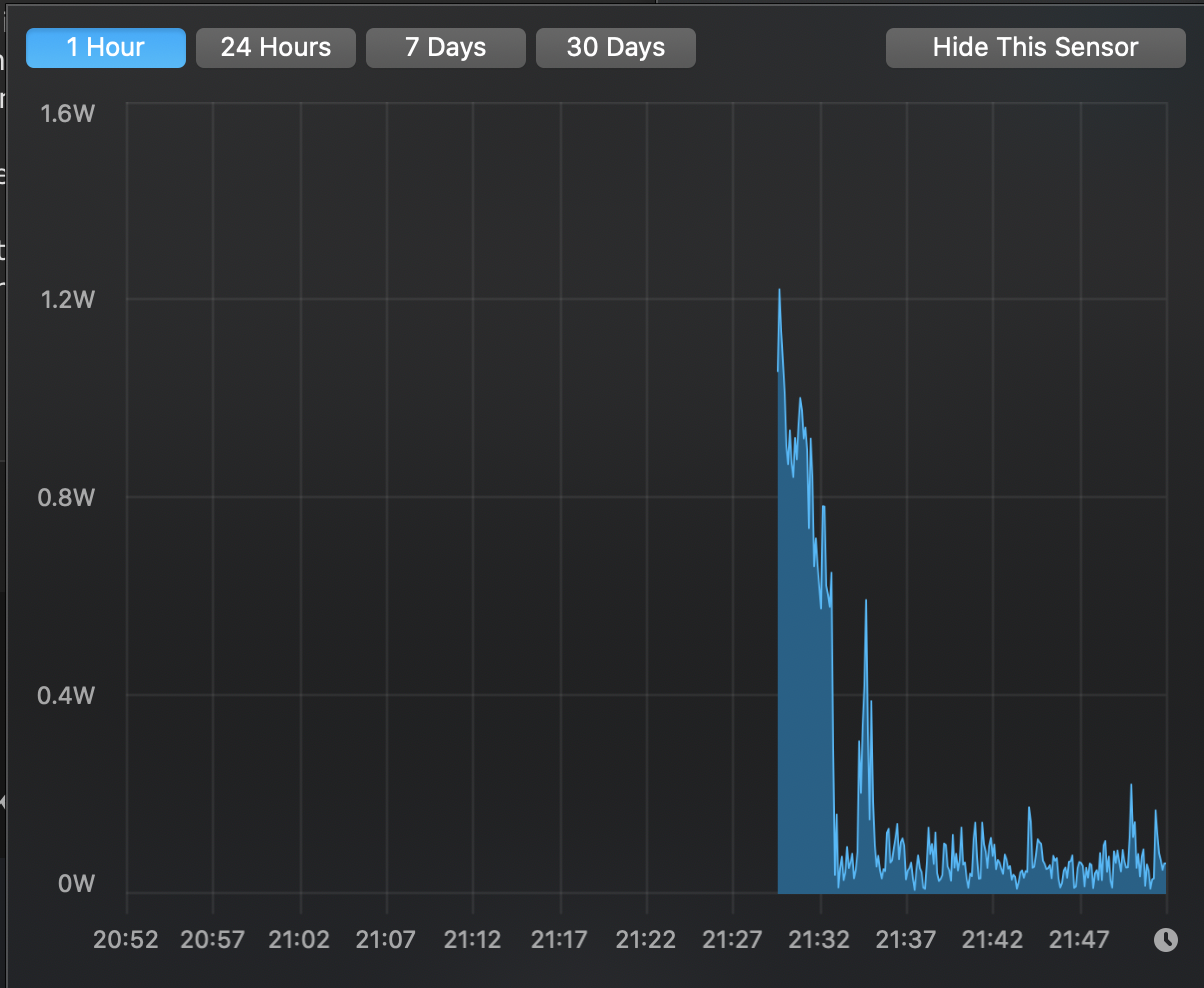

To check if APST is running or not you can check it in iStats -> SSD 3.3V. The graph of the SSD's idle state should look like this:

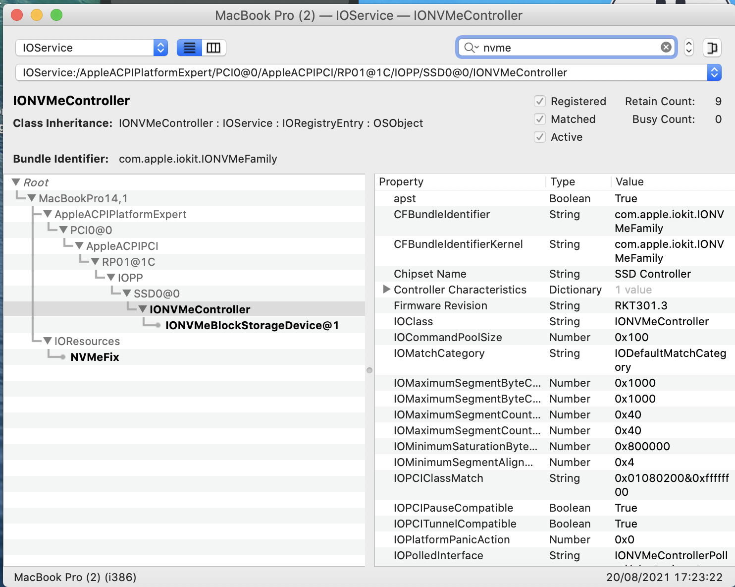

As I said in another post, I checked through IOreg if I could find the NVMEpmproxy variable, which I couldn't. In the NVMEFix github page, it says the following :
"If active power management initialisation is successful, an NVMePMProxy entry will be created in the IOPower IORegistry plane with IOPowerManagement dictionary."
Which let me think it isn't properly load. APST seems to be set to "true", though.

Yes, I did installed it through hackintool in /Library/Extensions too. I also disabled the SIP.
I used to check the stats with iStats and it seems thatt they where no difference before / after instlaling the kexts. I can try again and post the result as soon as I can. Thanks for the detailed message.

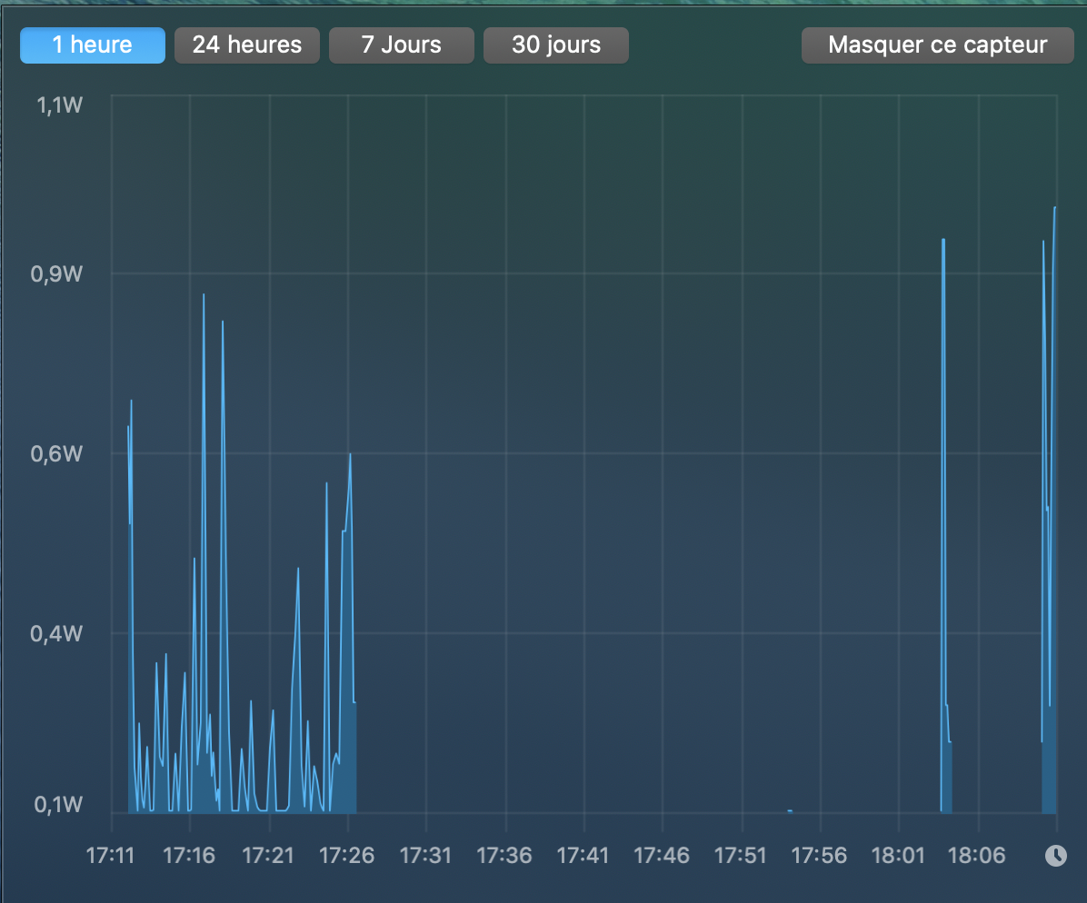

This is what iStats is saying for the last hour. 17h10-17h20 is internet browsing,17h26-18h10 is idle.

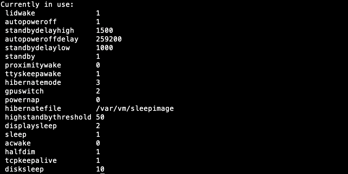

If anyone is wondering, these are my pmset settings :
I think this result is perhaps okay, as without these kexts, my SSD will eat up 0.3W when idle, despite the drive being more efficient compared to other drives out there.

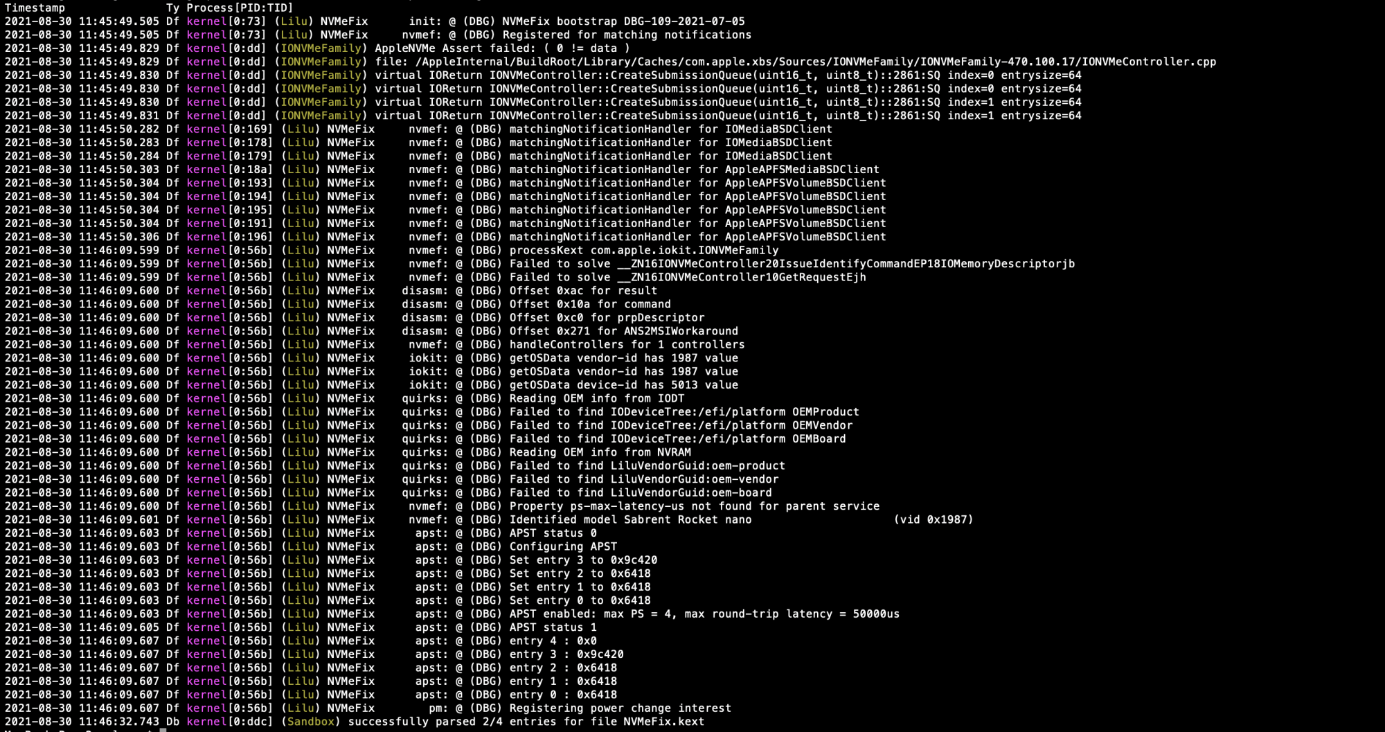

Here is the output of the debug version of NVMEFix :
I can see that APST is clearly enabled, but I don't know if something else need to be active.
Yep, that's it. You don't have to worry too much about the SSD. APST status 1 means that it is activated.
From the previous reading, during idle state your SSD use up 0.1W of power which is typical for a Sabrent SSD.

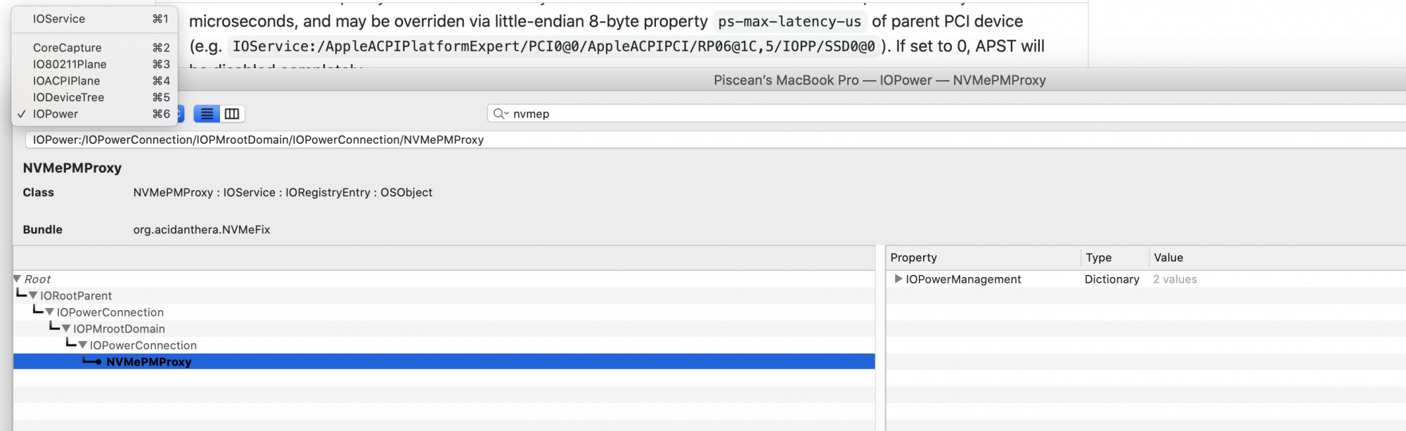

In case you still wonder where the NVMePmProxy value is, inside the IOReg app, click on the "IOService" drop-down list, select "IOPower" and you can search for NVMePMProxy from there.

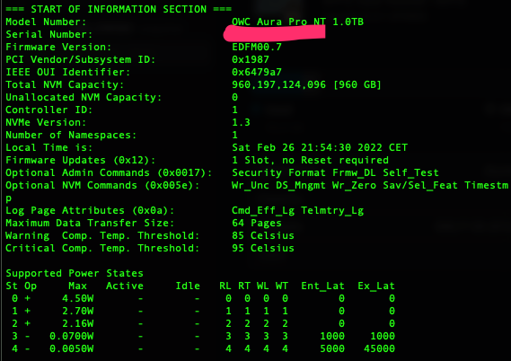

Hi, I also have an MBP13 mid-2017 and I recently upgrade for an OWC aura Pro NT 1Tb, thinking that I will get rid of this kind of problem, but... guess not.
My battery is draining like 20% in ~8 hours.
I installed SsdPmEnabler in a simple way:
$ csrutil enable --without kext
$ sudo cp -R ~/Downloads/SsdPmEnabler.kext /Library/Extensions
I did the grep command and it's running, but I didn't see any changes.
The smartmontools show me this:
$ smartctl -a disk1s1
But using iStat Menus, my "SSD 3.3v" is always showing 0,13w or more.
