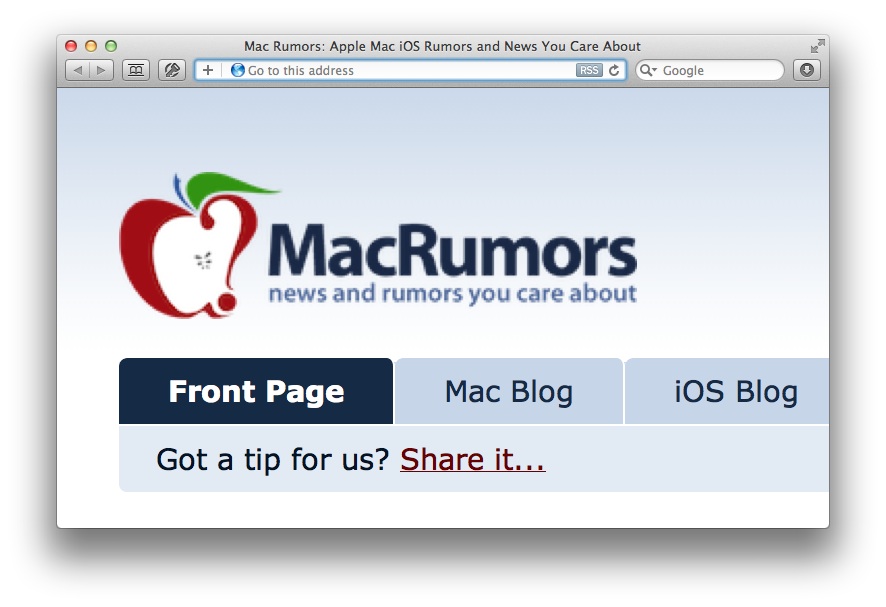

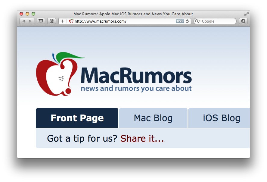

The funny thing is also that a lot of badly made websites will look great, as a lot of people don't properly resize images for their site but rescale the full-size image. This is obviously bad design and makes pages slow to load, but for retina its good.
Not just for 'Retina' but also for when you zoom into a website on a regular device. E.g. Macrumors @ 200% :
vs.
