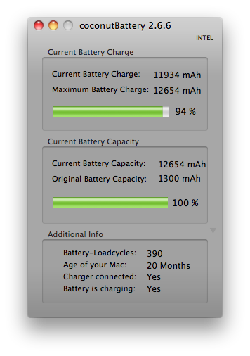

K Kahnyl macrumors 68000 Original poster Oct 19, 2010 #1 I don't understand the Current Battery Capacity here. Shouldn't the original be higher than the current? Attachments Screen shot 2010-10-19 at 18.05.19.png 60.8 KB · Views: 135

GGJstudios macrumors Westmere Oct 19, 2010 #2 Have you calibrated your battery? If not, the readings are likely bogus. This should answer most, if not all, of your battery questions: Apple Notebook Battery FAQ

K kingsal macrumors member Oct 19, 2010 #3 What kind of Mac do you have? What 20 month old Macs come with a 1300 mAh battery? Maybe it's reading your computer model info incorrectly. Calibrate it and then let us know if it persists.

K Kahnyl macrumors 68000 Original poster Oct 19, 2010 #4 The Early '09 MBP. I'll calibrate and re-check. Thanks.

K kingsal macrumors member Oct 19, 2010 #6 Kahnyl said: The Early '09 MBP. I'll calibrate and re-check. Thanks. Click to expand... 17" I assume? The max on that should be 12,774.
