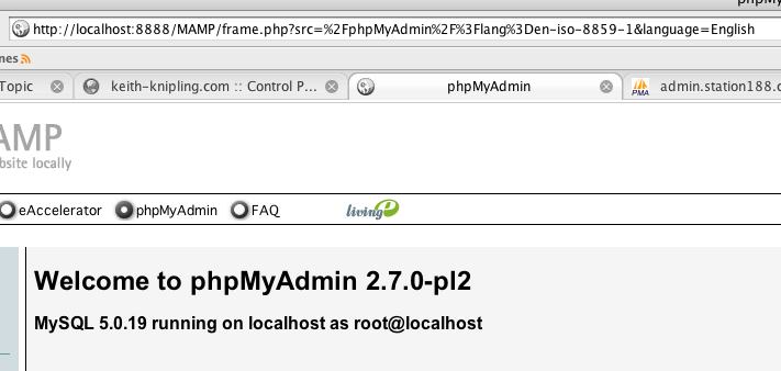

Here is a screenshot from phpMyAdmin, which says
"MySQL 5.0.19 running on localhost as root@localhost"
In CocoaMySQL I am trying to connect using localhost | user:root: password: root.
Thoughts?

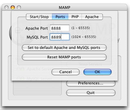

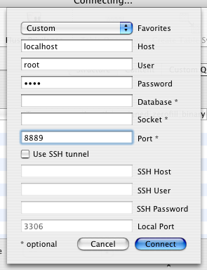

I tried both suggestions
1. Using the dafault port in CocoaMySQL, and changing MAMP.
2. Changing CocoaMySQL to port 8889, the default in MAMP.
Attached are screenshots from the latter attempt. Still no luck - MySQL says it can't connect.

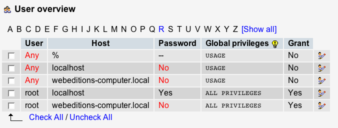

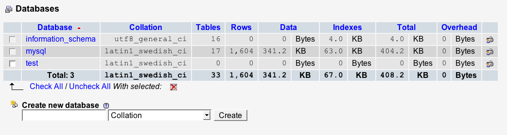

In the Privileges section of PhpMyAdmin can you set the root password to root (just to make sure that's what it is).
It's a bit strange that there are no databases listed to browse, I had thought MAMP created at least one for itself and MySql two (mysql and test)
If CocoaMySQL is still not able to connect as root root to localhost on port 8889 I'd probably look at uninstalling and re-installing MAMP. Seems a bit screwy.

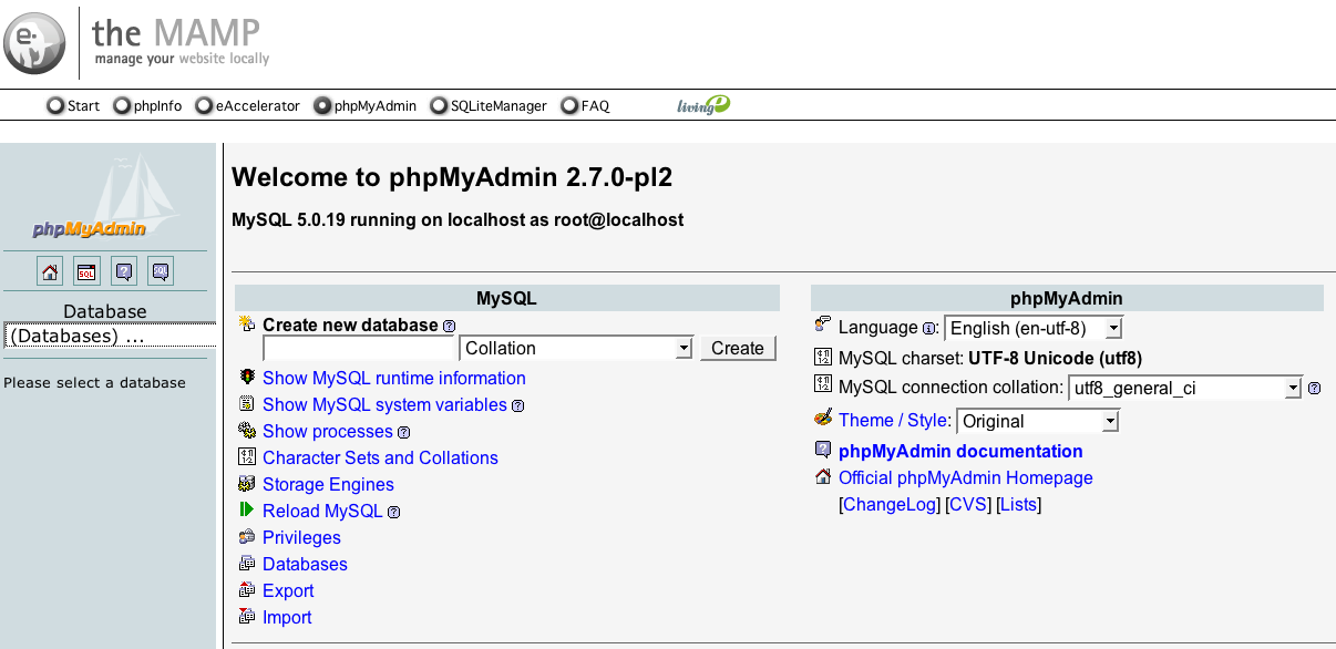

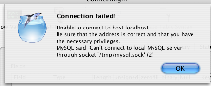

Here is the error from CocoaMySQL. I also took a screenshot from the phpMyAdmin panel. There are databases.

Try this in the Socket field of your connect dialog (assuming you put MAMP in Applications)
/Applications/MAMP/tmp/mysql/mysql.sock
There you go - wait long enough and someone who actually knows what they're talking about will eventually pitch in 😛
