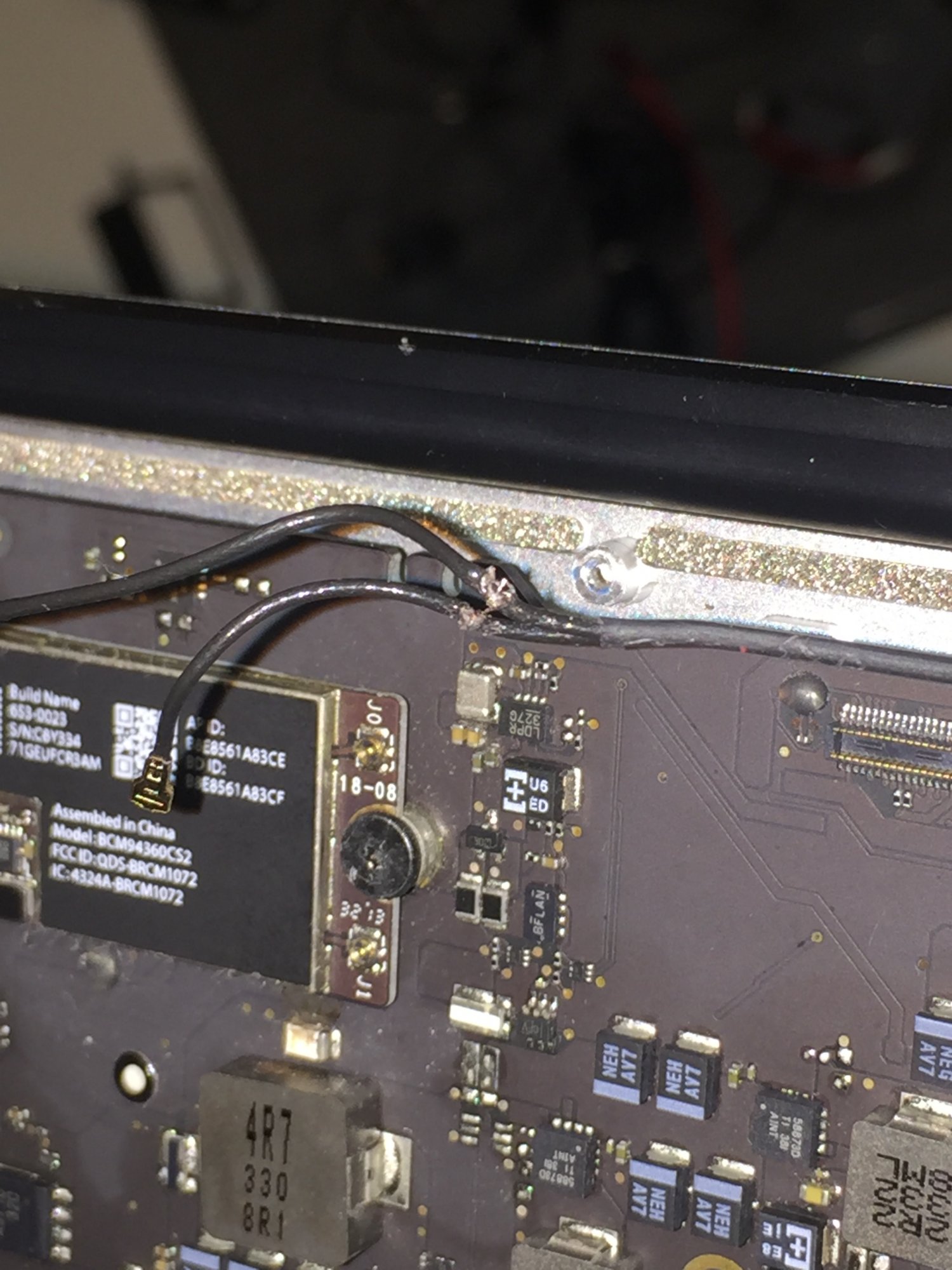

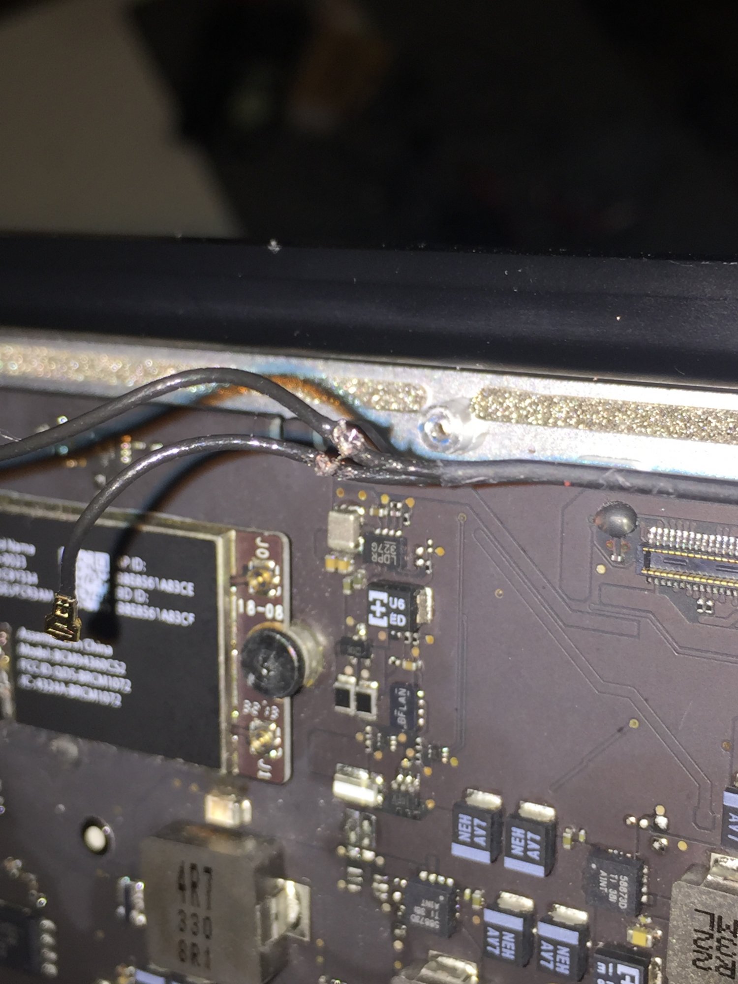

Sigh, well the wifi issue was completely my fault. I didn't put the antenna cables back correctly and when screwing the bottom of the Mac back on, I shredded the antenna cables! I will add pics shortly.
I delicately plucked them out and used electrical tape to seal them up. Wifi speeds seem more in line with the MBP, with now 78Mb/sec download and 50MB/sec upload on the 2.4GHz network.
Both the MBA and MBP have 802.11n adaptors. Edit: incorrect, the MBA has 802.11ac!
Upload is still lagging behind the MBP, but I hope that's just some kind of natural variation.
Yuck, would have been a real pain if I'd made it any worse, changing the antenna cables would be a nightmare!

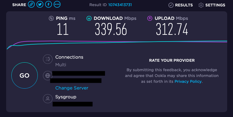

Great speeds on 5GHz WiFi

For anyone interested, here’s the hash I made of the WiFi antenna cables when screwing the base back on. A mix of carelessness and bad luck.
Managed to wrap them both with electrical tape and tuck them in and all seems well...

I damaged some connectors are the end of the wire so I took wires from a cell phone and spliced them together. The connector on the end of the cell phone antenna wire is the same connector. Instead of electrical tape, I used shrink wrap.
Reactions: Sharky II
