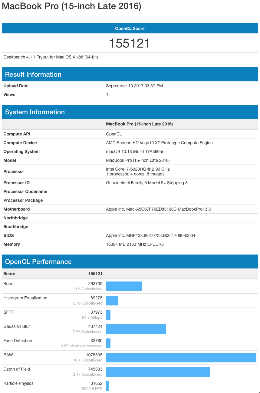

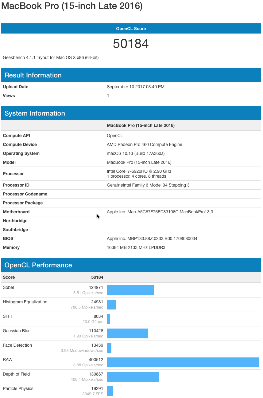

[doublepost=1505064245][/doublepost]These numbers any good? RX 64 in the Mantiz eGPU vs Pro 460 inside the MBP.
Well, I think I've narrowed down the freezing issue to the GPU itself... I tried a different external drive to run High Sierra, but it had the same slow/freezing issue... As soon as I switched off the eGPU, everything ran just fine. Must be the current drivers in High Sierra that are making it run like this...
Right now I’m trying to figure out the freezing with the manufacture, who has been absolutely amazing by the way… I reseated the card and that seems to have helped with the freezing… But the littlest movement causes a freeze or unfreeze… Would that mean something may be wrong with the card itself? Maybe I'll get a new GPU... Maybe the cable is the issue? Seems like the computer keeps working in the background, just the screen freezes up?
