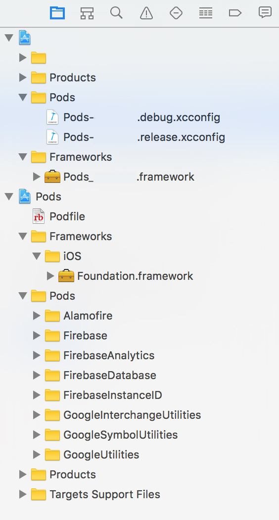

This is a GitHub project I'm working off so I'm not the creator. It's working perfectly and I just want to better understand the file structure and linking.
Obviously when you are in an Xcode project and and create a Pod file then run pod install in Terminal the workspace is created for you and you get the extra blue Pod project icon with the new folders.
But...why are there two Pods folders and two Frameworks folders and an extra blue Pods project icon?
A Pods "project" is created for everything related to Cocoapods? Why is there an iOS Foundation.framework there? Shouldn't it be in the main Project yellow Products folder?
I also see the Pod file the creator used. Why is it there instead of the main yellow Products or Supporting Folder and how did it get the red rb on the icon? Usually it's just a plain white icon.
Also why is there is a Frameworks folder in the main project which contains a Pods_projectname_.framework?
What exactly is Pods-project-name.debug.xcconfig for?
Thanks

While I haven't used this project it seems that you're looking at the example project. The crucial part of using his code is the one source file. The other source code is to make a complete example.
Carthage is another dependency manager like cocoa pods. Use one or the other, not both. Or use neither. Just add the single source file like the author mentions. When you use CocoaPods it downloads the required source files and builds a framework and does some other stuff with your project and builds a workspace.
So, add the one source file to your project or do it the cocoapods way. Your choice.
