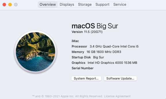

Is the 11.4 causing all hackintoshes to fail?
Mine is running well - My motherboard is an old one, no longer available, but was marketed as being suitable for AOS (Any Other System). I have had numerous cold boots and warm boots over 25 of each without any problem. (I am not using 'LateBloom'. You will see from my signature that my 'Hackintosh' is a 2013 Z77MX-QUO-AOS board, I'm using the H40-OpenCore Boot ROM and now have the config.plist set up as a iMac 16,1. I have not added an additional Graphics Card but simply use the built-in capabilities on the MB (Intel HD 4000)
I ran 11.4 for over a week then a few days ago installed 11.5 beta RC. It's now booting superfast - Safari Video playback is smooth. Apple TV playback and Quicktime playback smooth with no trace of any artifacts.
HOWEVER, from my reading through the posts on this and other forums - most Hackintosh users are reporting the same or similar problems as those with cMP 4,1>5,1 and cMP 5,1 although not so frequently.
(When I find a reliable PCIe WiFi card for Monterey and the prices of graphics cards return to 'normal' I'll add them to it and upgrade to Monterey.)
