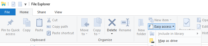

  15. belvdr macrumors 603
    Joined:
    Aug 15, 2005
    Location:
    No longer logging into MR
    #16
    To give it a drive letter, open Windows Explorer. Click the Home menu ribbon, click Easy Access, then Map as Drive. Enter the drive letter and UNC path (\\server\share).
    If you are using the same username and password as you do on the iMac, you should be able to. I'm not a macOS Server guy.
    Speed what up exactly? This sounds like it should be a new thread if the iMac is slow to start with.
