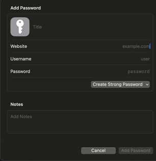

Thanks. The script runs now but did not mount the volume.
Just curious if there's any special criteria for having the password stored in keychain? I've put the NAS server name as the website, and the username/password.
If you set the timeout to a higher value like 60 seconds
Bash:
my_time="60" # timeout in seconds
and uncomment
Bash:
#DismissPopup
do you get any popups to enter the password?
If so, do enter it and make sure to tick "Add to keychain".
You said you can connect via Finder. To confirm the correct values for the script, does it also work via Finder by clicking "Go > Connect to server" and enter the address like:
afp://TheUserName@TheServer/TheNetworkShare
