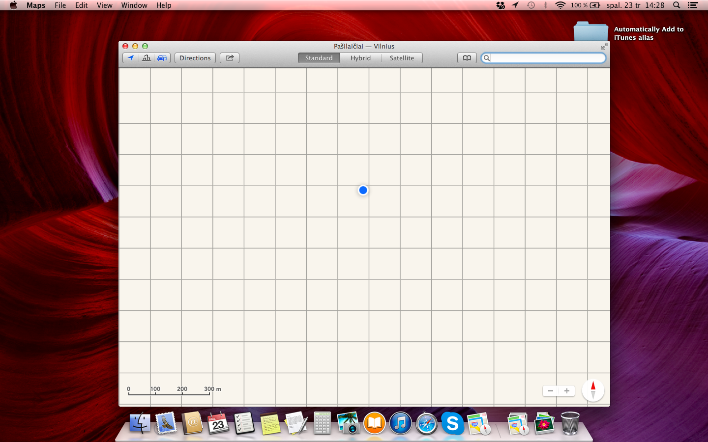

for me it is like that:
no issues via hybrid mode, only via standart
Tried rebooting, full screen, nothing helped

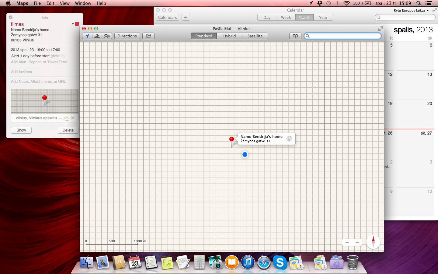

Same here. I don't even have a grid in standard view. Blank map with just the blue point of the location. The map is here when I open the app and then disappear.
Works quite fine in other views (hybrid or satellite, but also sometimes disappear) and works perfectly in fullscreen mode.
