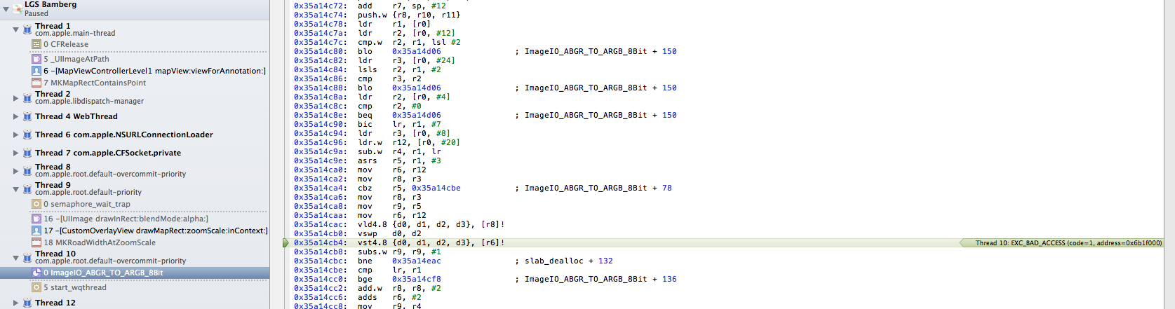

And this is a screen shot from the crash in xcode (please see attachment)
So from the crash log:
Exception Codes: KERN_INVALID_ADDRESS at 0x05c74000
Crashed Thread: 7
and a little further down
0 ImageIO 0x35a14cb4 ImageIO_ABGR_TO_ARGB_8Bit + 68
It's failing during this call with a Invalid Address:
[image drawInRect:theRect blendMode:kCGBlendModeNormal alpha:1.0];
Did you verifiy that image is loaded sucessfully before calling this?
Also, is ther any info in the console log in xcode?
Thanks for the answers so far! I have the images in the main bundle under the resources-group ... I just tried to call it this way instead:
Code:
UIImage *image = [UIImage imageWithContentsOfFile:[[NSBundle mainBundle] pathForResource:@"theImagesName" ofType:@"png"]];
	UIGraphicsPushContext(context);
	UIGraphicsPopContext();
but it gave the same result... The console doesnt say anything... unfortunately...
Thanks for the help so far - I really appreciate it!
I would set a breakpoint here:
Code:
I'd check to see if the image is not nil, and step line by line to confirm that the drawInRect call is indeed failing.
