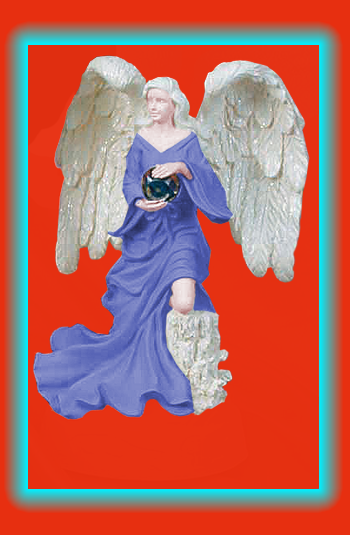

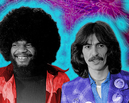

I hope this works, first time uploading files
The image of the angel is the one I'm having problems with, I create a layer and use a red background then use the lasso tool to cut the background from the image layer. I then apply the glow filter from the layer palette and choose precise, this technique allows me to see stray pixels I might have missed when cutting out the background from the image.
From what I noticed is the background doesn't seem to be cut out completely and the glow is showing around the whole image.
This is also happening if I use the stroke effect.
The image of Billy & George shows how I have been able to do this in the past. You will notice that I didn't clean ALL the stray pixels in the upper right hand corner, as well as in between Billy and George heads.
I hope I described my problem where it makes sense to you.

It helps to describe it a little bit. From the looks of the angel image there's still a background to it, or at least there's no Alpha channel.
Try using the Extract Filter to remove the background. It helps a little more with things like that and uses contract between edges to remove backgrounds and add alpha.
Highlight the edges of object with green, and fill in what you want to keep with blue.
Or, try the eraser tool with a feathered edge to remove the background, and make sure you have the checkered background.
Nothin' from nothin' leaves nothin'

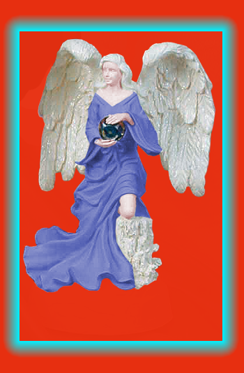

I can't say for certain what is causing your problem. I've followed the steps in CS3 without a problem. PSD file is attached for comparison.
