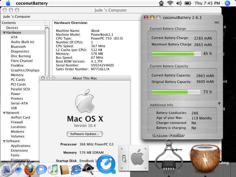

yeah shes doing okay but my computer feels sluggish for some reason check out the pic.
