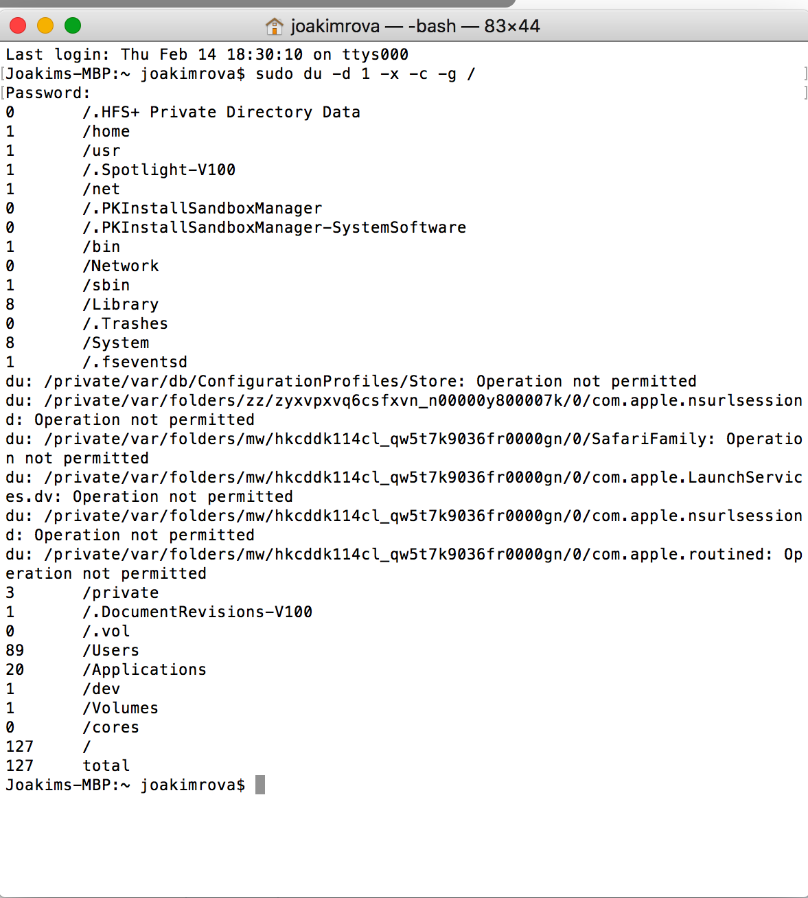

[doublepost=1550167442][/doublepost]I got this now:
I don't see anything off these assuming about 89GB is personal user files is about right.
So the issue then is that storage graphic in About this Mac is way off. Let's try two things.
First, hold command-r (both keys) at boot up to get to recovery mode. Then start Disk Utility and run First Aid on the disk to see if that finds and repairs any disk errors.
Then reboot and run the Terminal command below to reindex Spotlight. Give it a half hour or so to complete. That storage graphic gets data from the Spotlight index, and if the index is corrupt is can be inaccurate.
