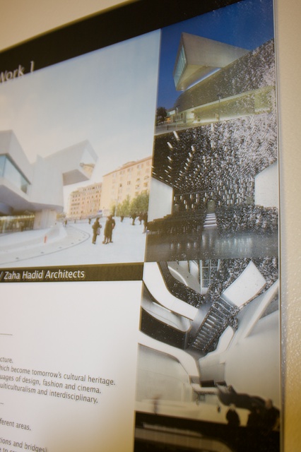

I'm at uni and trying to print from the university printers in the library - the colour printer. I'm in my second year and the paper is so rubbish its nearly see through so I've bought a pack of A3 paper/card but some of the ink doesn't bond to it, or gets brushed off before it drys... something like that.
Printer -
It's a HP printer, I will edit this post soon with the exact model
Paper -
I've bought 250 sheets of A3 paper/card
Its 160gsm
Brand: multicopy
Settings -
I'm using Adobe InDesign to work in and export.
I set black as registration which works perfectly on the card - I printed an entire sheet of black which is fine!
I'm exporting to a PDF using the default "high quality" present

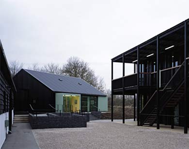

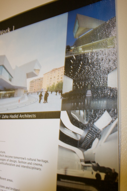

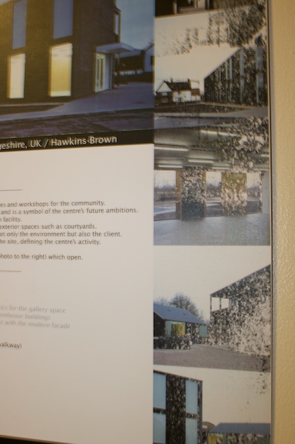

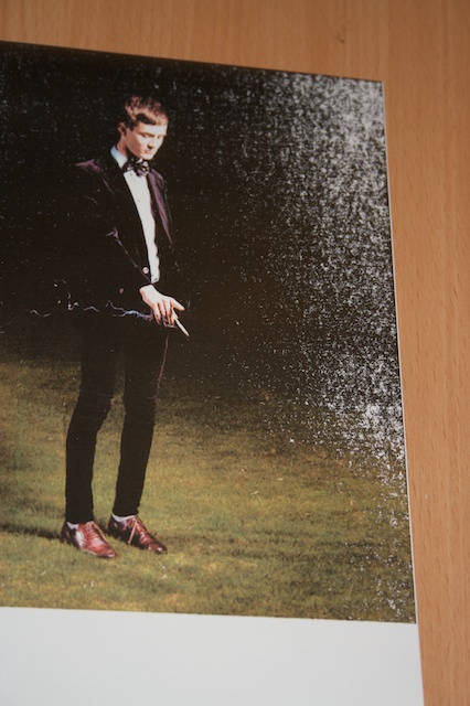

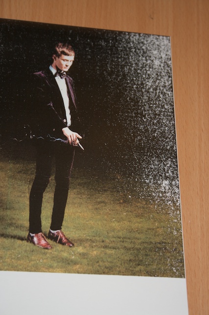

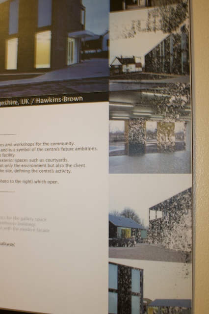

The problem is on images I have downloaded and placed in, photographs to be precise.
It appears to be the black in photos
Uploaded a photo below for your consideration
So would anyone have any advise which would help solve this issue please?
I HOPE YOU CAN HELP!
Luke.

It's hard to tell what's going on, to be honest. It looks like toner/drum problems over saturated areas that contain more than just black toner. Do you have to use the library printer?

You can try, but I doubt it's going to make a difference. It seems a printer/stock problem where the toner is not taking to the stock, possibly because of the colour drums or even lack of toner, it's hard to tell. The fact that you can run out black with no problem hints at issues with the coloured toners.

pretty sure it's the paper not being right for the printer.
I've had similar effects where the 'ink' just isn't being absorbed and gives similar output.
Assuming it's a laser printer, basically what's happening is that the toner isn't fusing correctly to the paper, ergo the paper is probably the problem. I'd buy some HP paper. HP drivers for the Mac are usually pretty reliable and you should be able to select the exact paper type in the driver. A little bit more expensive, perhaps, but then you won't be wasting so much.
I have this problem when trying to print on some Avery labels, the surface just isn't compatible with the HP toner.

It's just a setting...
Most likely this is the culprit because I had a similar occurence:
Laser printers fuse the toner to the paper and certain paper requires a certain amount of time for the printer to heat the toner and fuse it.
With the black "flaking" off, it's not being fused properly. On our Xerox printer, we had to go into the printer's on-screen menu and change the paper type to cardstock, label, etc. - the type of paper you are using.
Heavier papers need more time so the paper is slowed while being fed through the printer to give more time for the heater to fuse it. I'd try a cardstock setting and then try again. if you are near the printer, you should definitely notice a difference in the time it takes the paper to feed through the printer after you've made the change. And, hopefully, you will notice that you no longer have flaking toner.
You may need to try a couple of different settings - but basically you want to use a setting for heavier paper / cardstock to slow the printer down and give it time to fuse the toner to your paper.
