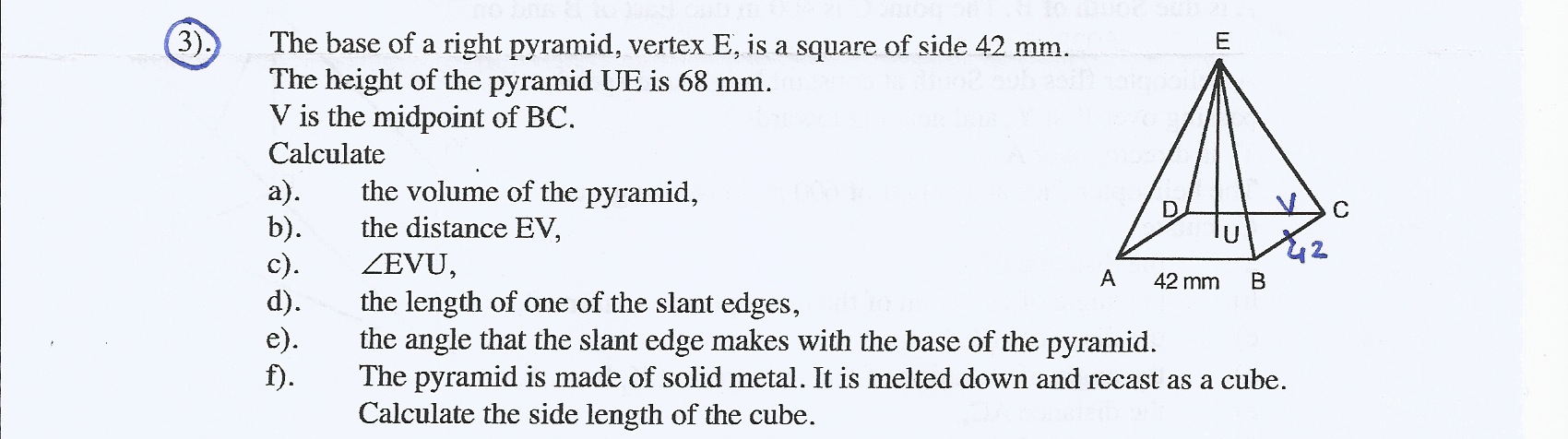

I interpret "slant edge" to mean one of the edges with an endpoint at E. I wouldn't call any of the base edges a "slant edge", but I'm in the US, you're in the UK, and I have no idea if that could be important.
So a "slant edge" would be one of the edges EA, EB, EC, or ED. They're identical in length because it's a right pyramid.
The line EV would NOT be a "slant edge", because EV is not an edge.
If we assume my interpretation of "slant edge" is correct, it's still unclear to me what 3e is asking for. It could be the angle EBU (or ECU, etc.), or it could be the angle EBA (or EBC, etc.). Either one could be seen as fitting the description of 3e. I would probably calculate both, label them clearly in my answer, and then write a brief note that the question could use some clarification.

EV is the distance between the vertex and the middle of one of the sides at the base, the slant edge connects the vertex E to one of the corners of the base (like EB).
same with the angles (EVU vs EBU).
