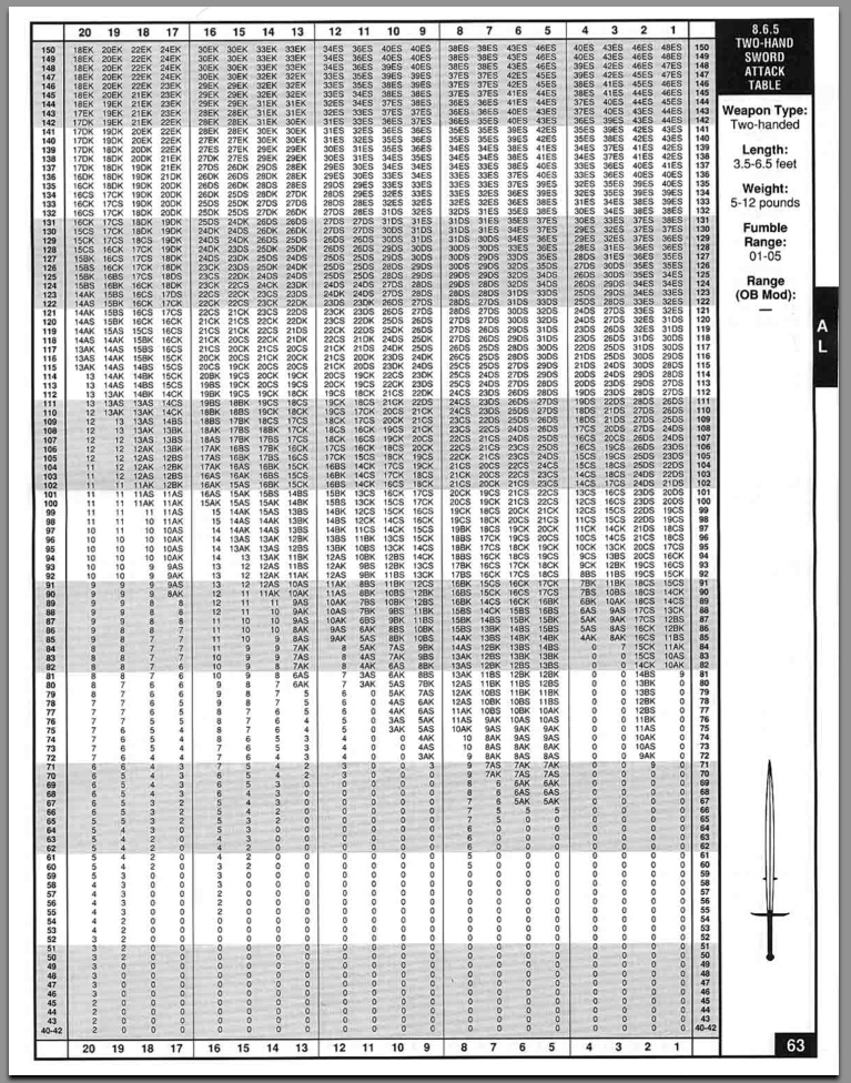

I have a C multidimensional array 'matrix[61][20]'. I included a photo of what I imported (it took some time to enter it).
The problem is that the chart I used starts with 20 at the top left. So when I print out a row it is backwards. 20 is where 1 should be 19 is where 2 should be and so on.
If you look at the chart the very top 150 and 20 which has a value of '18'. I need it to be 150 and 1 which should be a value of '48'
Is there a way to get it to flip the matrix?

ha. I was about to ask you what f(x) was. I suppose I could run it through a Switch Statement and make 20 into 1 and so on. I was tossing it out there because Objective - C is so vast someone might say "Just use the reverseMatrixMethod that is standard that everyone knows about but you 🙂
I already have my 2d array set up. I painstaking wrote down all the numbers from 40 up to 100 and placed each number line by line (1200 total) into a .txt document. Then I read in the file into an NSString and used a double for loop to populate the 2d array. Everything works, just every line was backwards.
