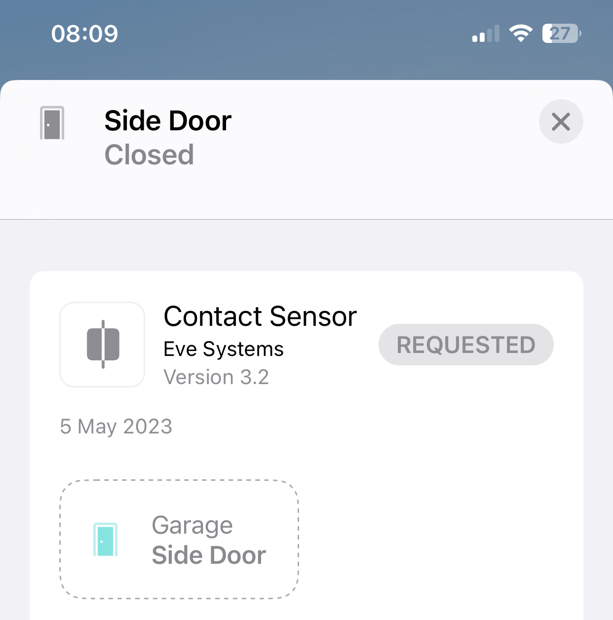

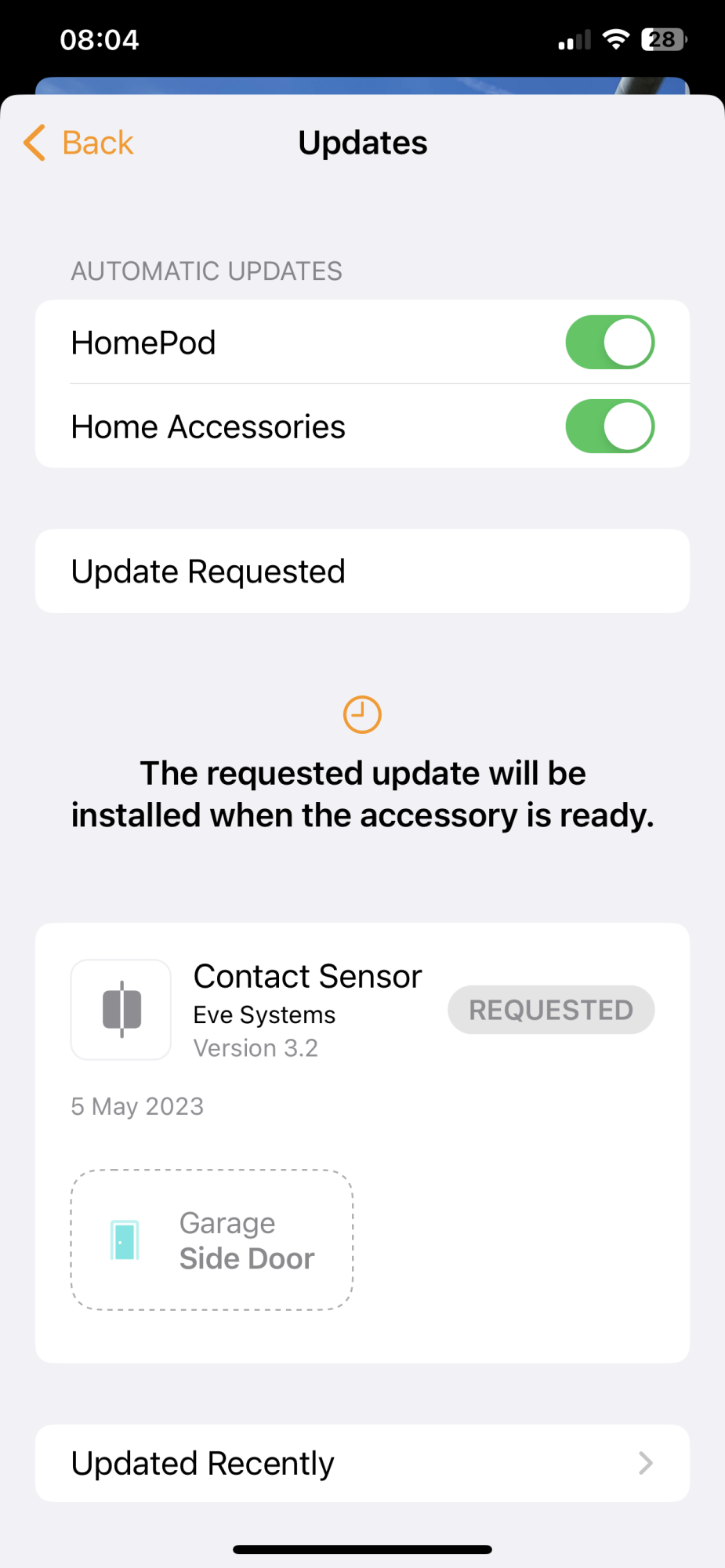

Anyone have anything similar to this within home settings/software update in the home app? It's been like this for the last couple of versions but according to the Eve app, the devices are already up-to-date (matter updates). TIA.
I am seeing these Eve updates for all devices on Matter protocol. Oddly, the Door & Window sensors are only updating one at a time, I am not getting multi-updates like you have on your screenshot
Reactions: StumpyBloke
Thanks for confirming. For days it was only showing 4 devices. Then 5. I've just checked again and it is still showing 5 even though I have 6. I have a feeling this might be more of an interface bug, and that the devices are actually updated. At least, according to the Eve app they are.
I have this notification for weeks now whereas the sensor itself has already updated to the latest firmware! 🤷‍♂️
What I find bizarre is that I can no longer update the firmwares via the Eve app 🤔

Thanks again for confirming. Exactly the same for me. I do think this is by design though that only HomeKit updates them or at least we have no manual control over updates. Personally I don't like this kind of lack of control but it is what it is unfortunately.
