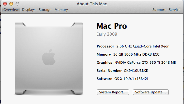

I've just done the self-same upgrade in my Mac Pro running 10.9.1 - going from GT120 to GTX650Ti. No stuttering here at all in system and other operations

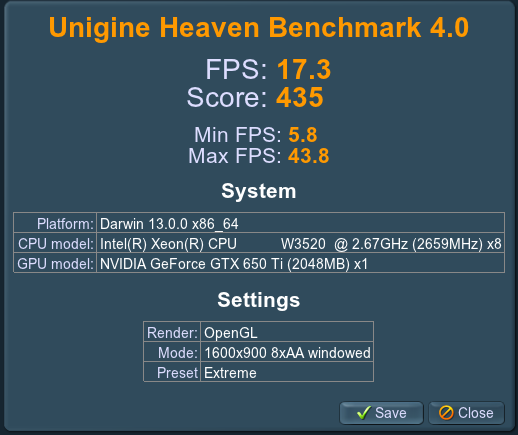

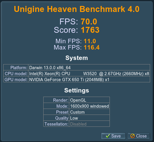

interesting. you think maybe my card is bad? could i ask you to maybe post some unigine scores to compare with mine and see if there's a noticable difference? i'd more than appreciate that.
on ultra/max settings i'm averaging 16fps with a score of 403
on lowest possible settings i'm averaging 66fps and a score of 1672
(@ 1600x900) are these acceptable ranges?
Sure, no problem.

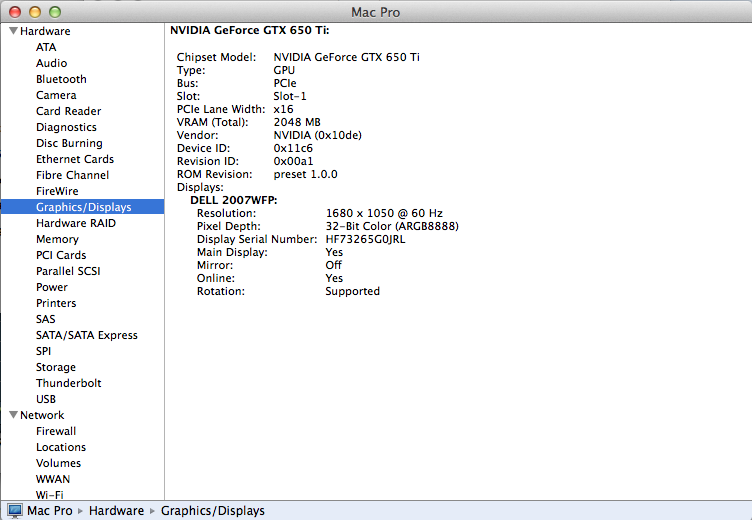

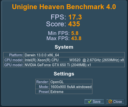

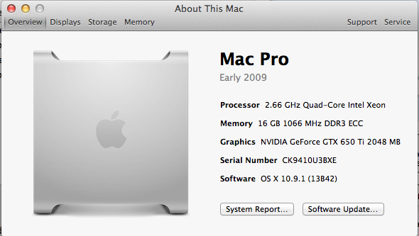

Basically similar figures to you are reporting- note this is windowed rather than fullscreen, whatever effect that has!
FYI card is a Gigabyte GTX650Ti 2GB - box says it is over clock version but I have done nothing other than throw it in the Mac and used as is (no boot screen)

Sure, no problem.
thank you very much for that. looks like i can assume my card is okay, just need a fresh install of mavericks to tidy up a bit. thanks again!
