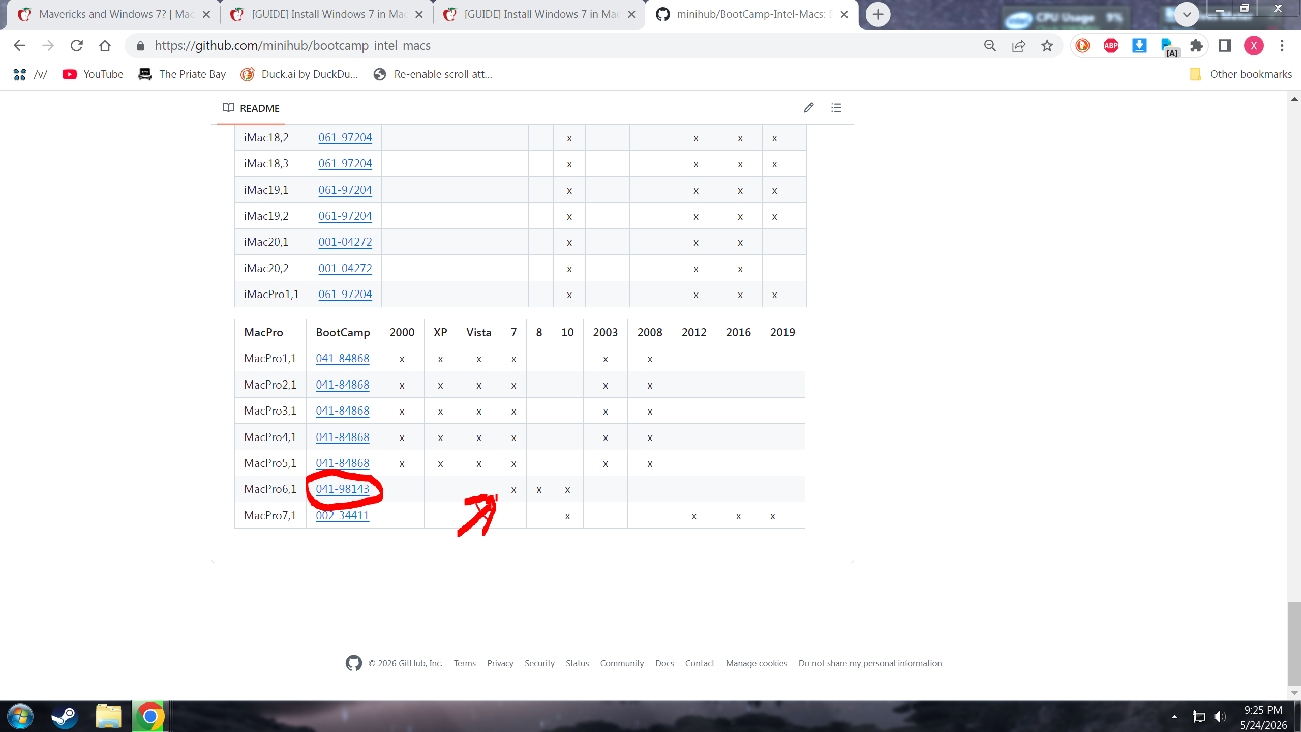

Go here "https://github.com/minihub/bootcamp-intel-macs" then select the "Mac pro 6,1" at the very bottom of the list.

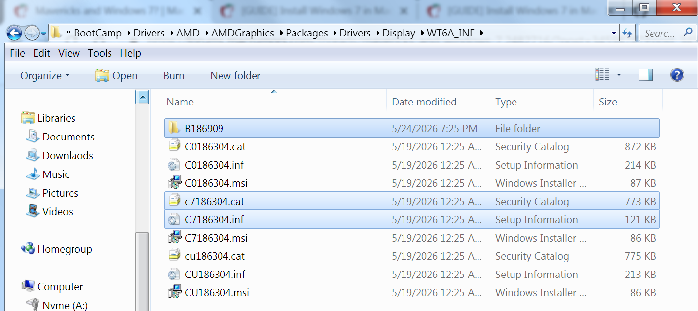

After your download then extract the files, go to “BootCamp-041-98143\BootCamp-041-98143\BootCamp\Drivers\AMD\AMDGraphics\Packages\Drivers\Display\WT6A_INF” folder and select the “C7186304.inf” “C7186304.cat” files, and the “B186909” folder. Do not select the other Driver files, as they are for “Windows Blue” witch is the prototype name for windows 8 (not windows 8.1).
The “C7186304” driver is made for Windows Vista, but it should not be a problem as Vista is older then Windows 7.
There is two drivers for Windows 8, most likely one of them was a Windows 7 driver, but got accidently named or configured for “Windows blue” (Again windows 8). The Msi file requires the “Catalyst” software to be installed, and that’s not possible on parallels for some reason, even if you did you have to have the gpus installed (As in connected to the os) for the Catalyst software to do anything. The bootcamp support software DOES install the drivers automatically, but only after you enter a computer name, password, and windows update option. Making it quite unhelpful (it also requires .net 4.5 to be installed, most likely something windows 8/8.1 already have installed)
So this means that the only way to install these drivers is BEFORE Windows gets installed, as in the .wim/.esd file. For some reason the .esd file (even when converted to .wim) that bobtheboney has supplied won’t accept ANY drivers to it. I just get a “Error 30” when trying to put drivers on it, even when im booted into windows 10 with its version of dism. That means we are going to have to manually replace the Efi files to get this to work. (Im not sure if I can upload the edited .boot64 and other efi files to mac rumors forums so you are going to have to extract them from the .wim (not the .esd, they are not in there) from the .iso that bobthepony supplies.).

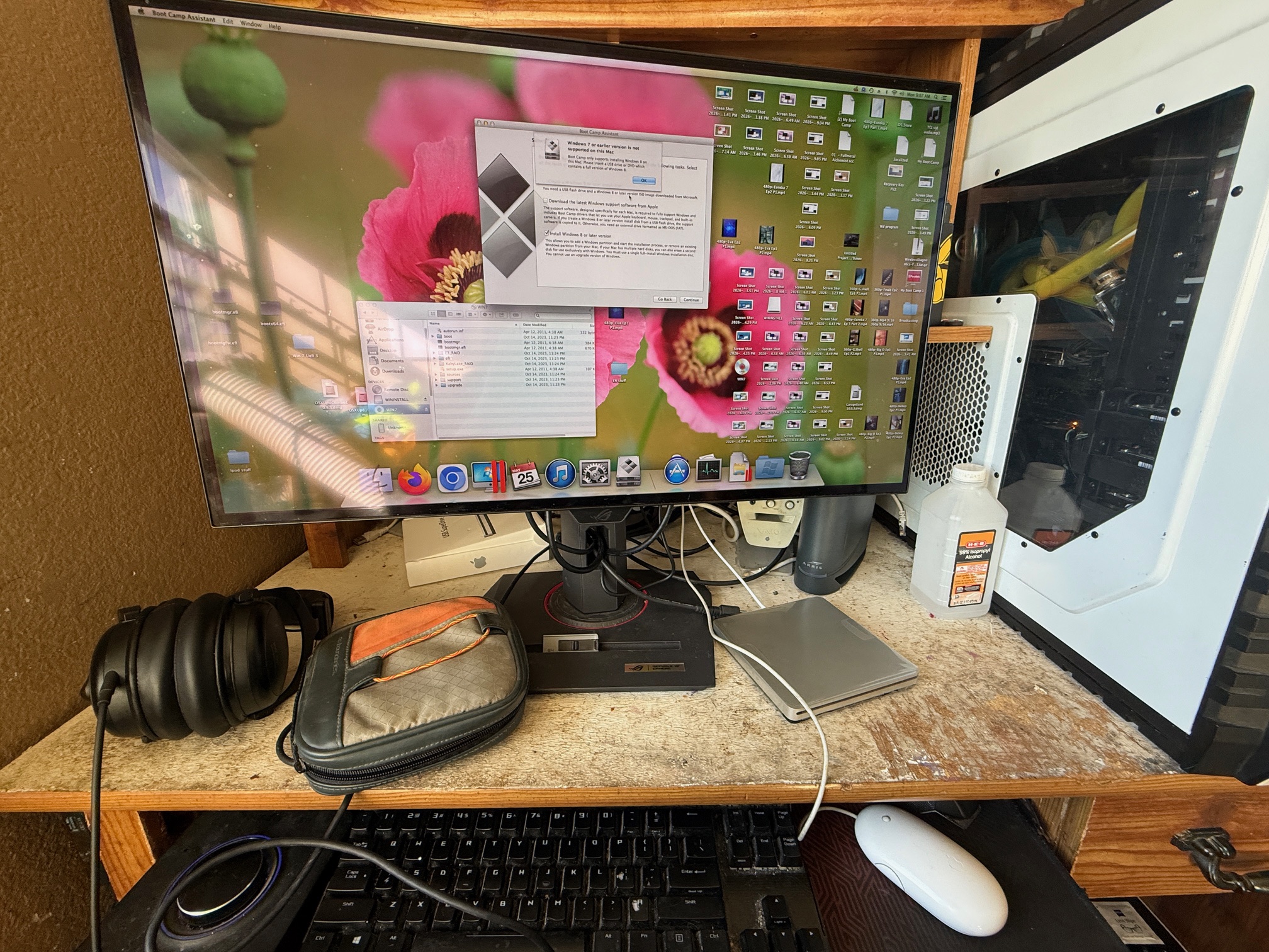

Okay so this is news, I went and looked around and found someone had a Mac pro 2013 that was able to install Windows 7 natively with the bootcamp installer. I am not sure, but its possible that this said person had a Usb super drive loaded with a Windows 7 disk. That or Osx Mavericks 10.9.1 has something different that 10.9 and 10.9.5 does not. Tell me what do y'all think? https://forums.macrumors.com/threads/windows-7-pro-on-mac-pro-cylinder.1703359/post-18732575
Reactions: Halian

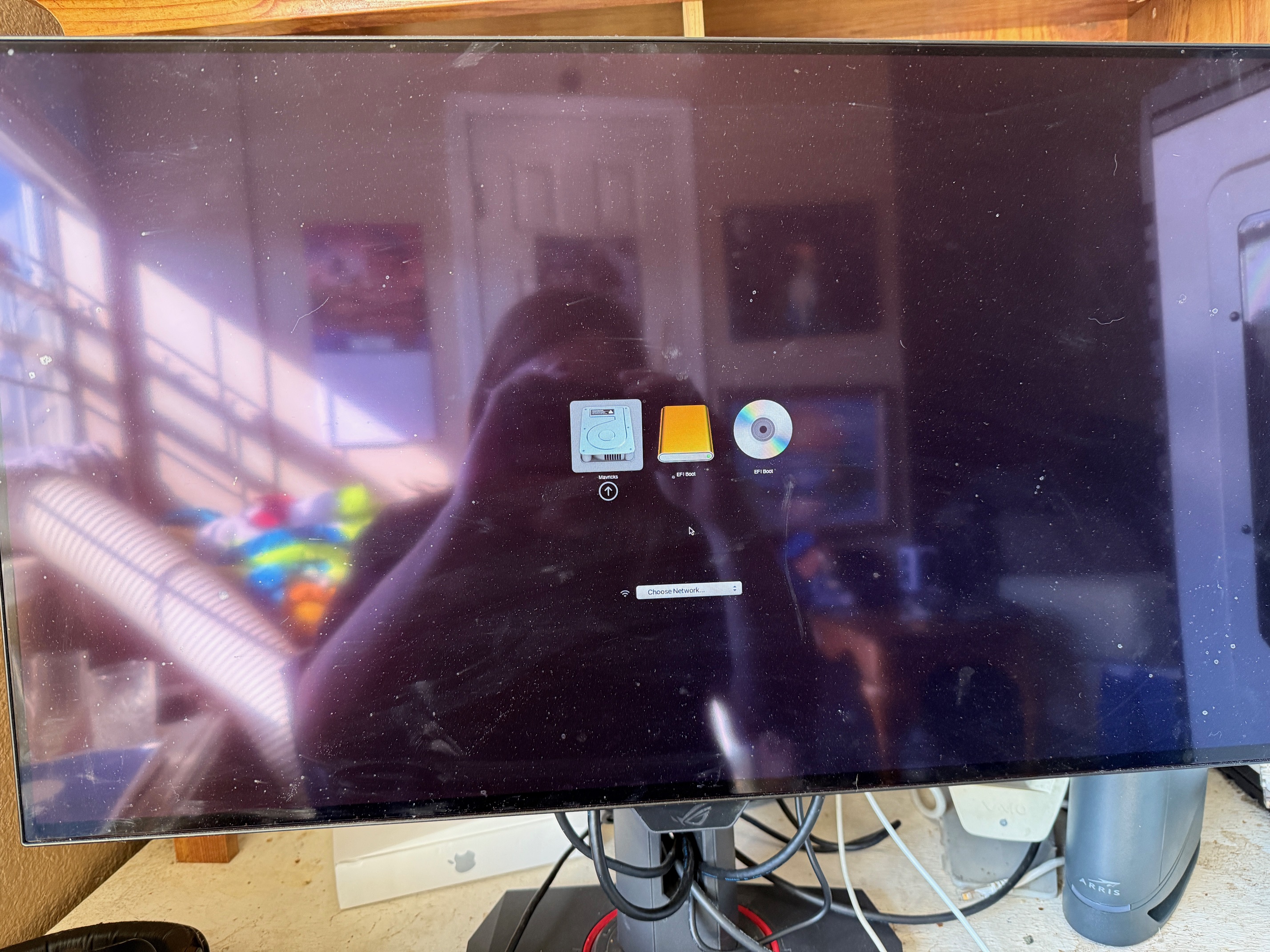

Okay so I found something out, in short the Hdd method does not work, as when you have the super drive connected before pro boot, and windows 7 is installed, it just refues to boot, and jumps right ove to mavricks. I guess that the Mac pro 2013 is hard coded to not allow booting of a Windows 7 installer.

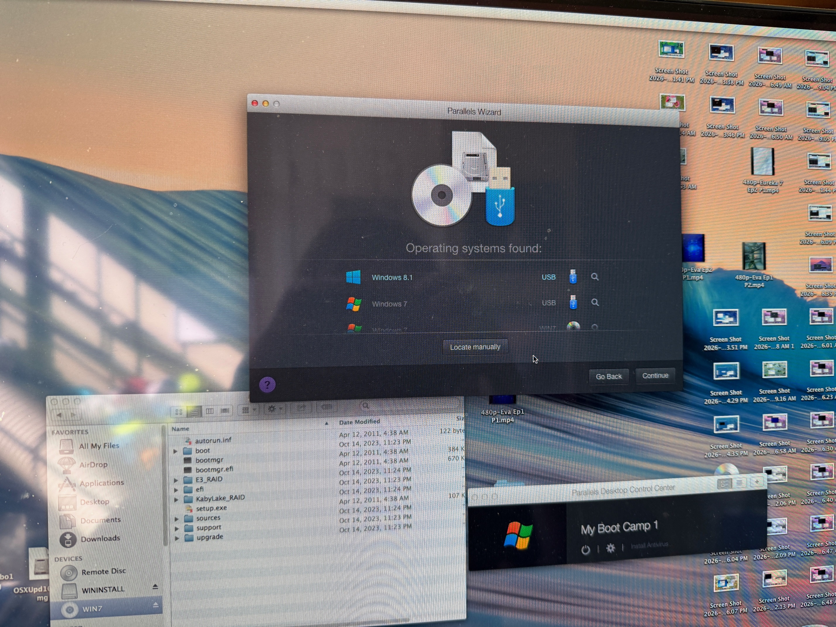

So the Win 8 boot image with a Windows 7 install.wim/install.esd is the only way to get it on there. I also opened parallels for the fun of it, and yes the os is seeing the Dvd as Windows 7. What I should try now is to see if I place a Ssd from my Mac book pro 2014 late, into the Mac pro 2013, would the system just boot into a non Uefi mode? Nost likey not but worth a try.
Also I did try to re run bootcamp installer with the Usb Superdrive Windows 7 disk attached, and their was no difference (I could hear the Superdrive spin up loadyly (Its brand new xD) so I know it was looking at it.).

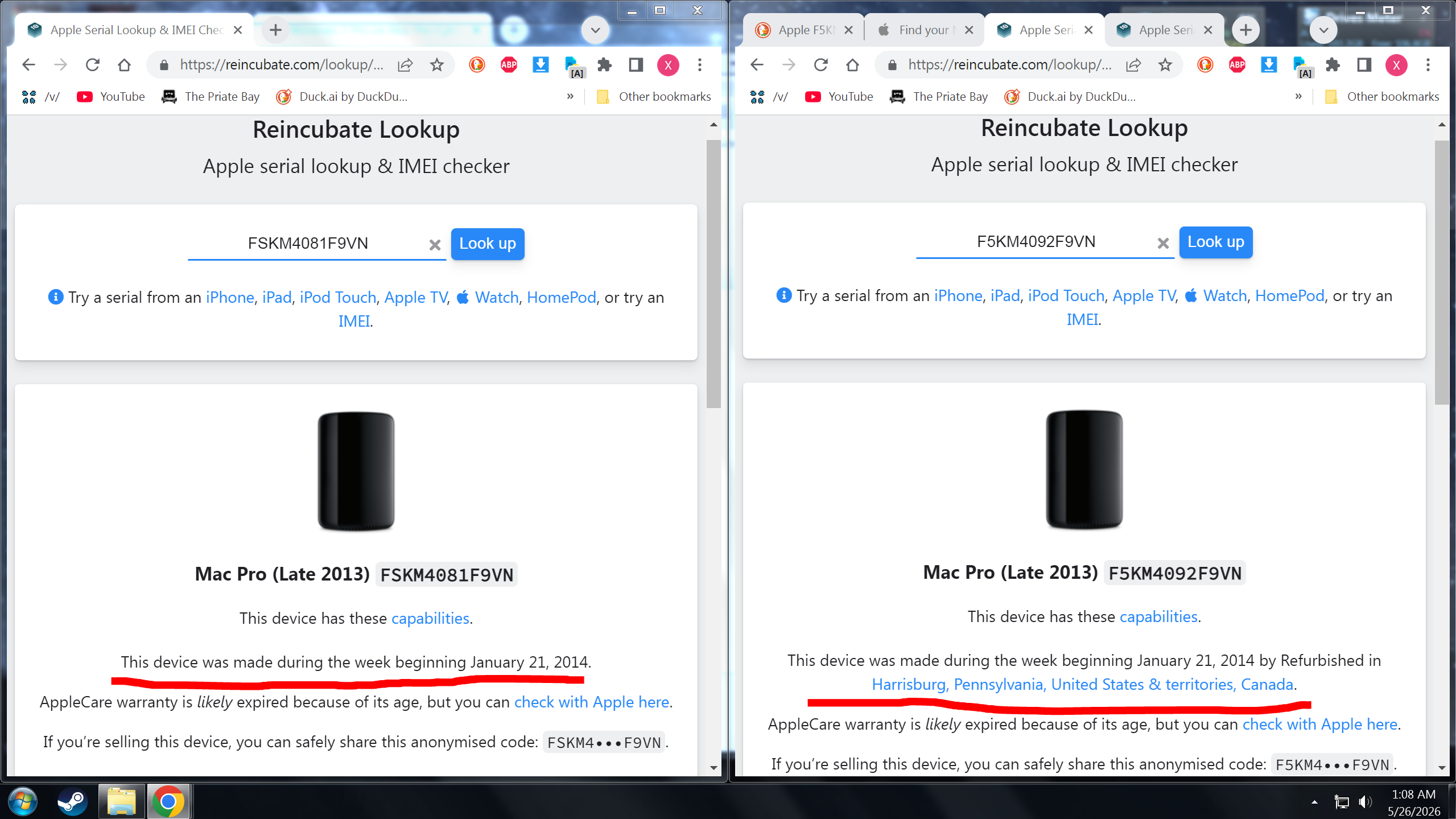

Huh, this is....strange. Looking up the serial number of this mac shows that is was a refurbished model by some company. The unit that does not have the Widows 7 support was not refurbished. Anyone know what this could mean? What in the world would this company do to this mac to have it give Windows 7 support????
Edit: This post seams to be a dead end. Of no use, the Mac pro 2013 is hard coded to use Efi, with Zero csm support. If this guys coworkers computer was able to do something diffrent, then I have no idea what is would have been. Maybe a older bios, that was in beta from apple?

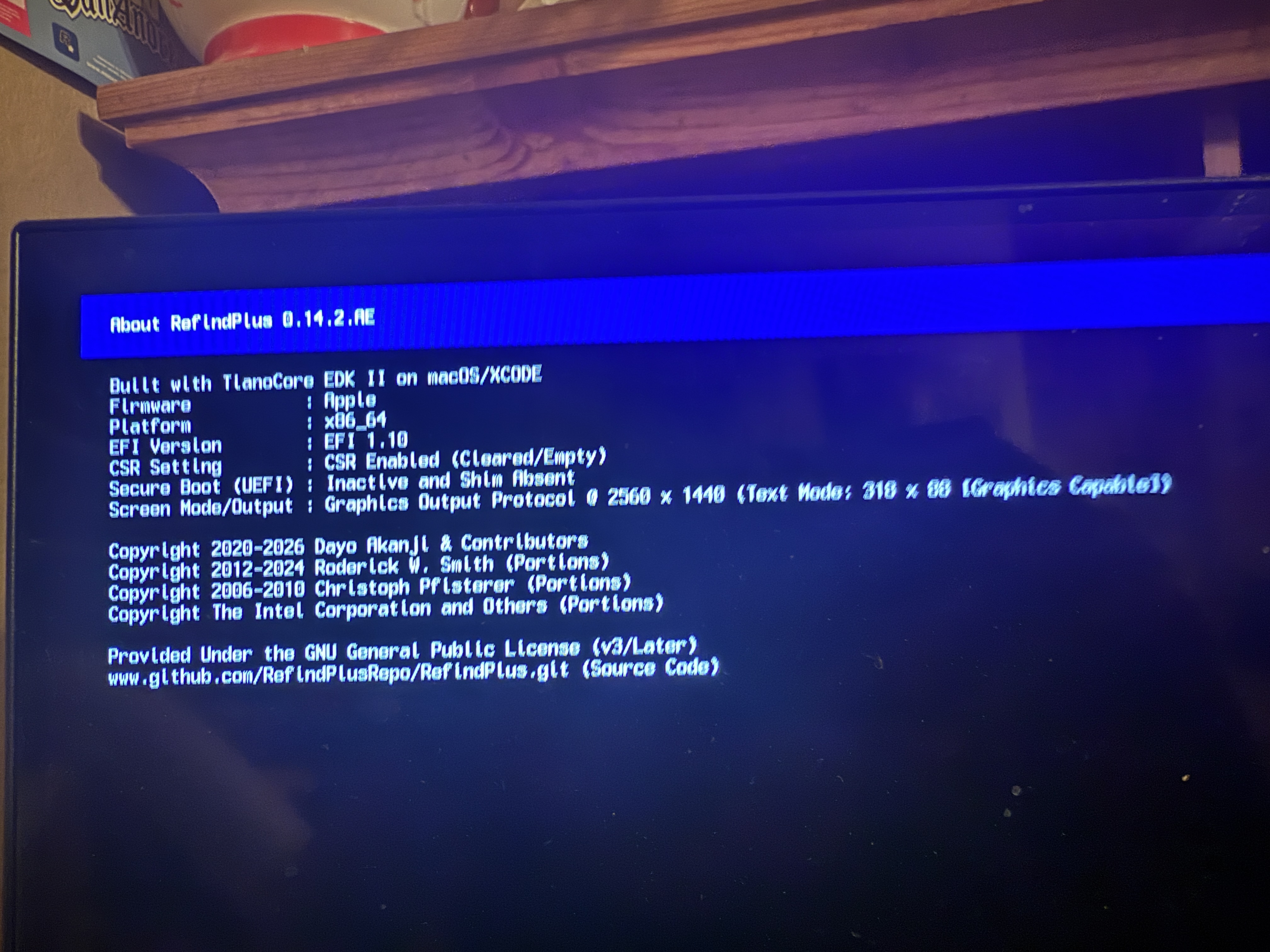

I actually did just find a way to install Windows 7 on a Mac pro 2013 :3 You have to use a bootmgfw.efi made by the Flashboot guys in order to have Gop running correctly. This this where I got this file from that worked for me "https://github.com/manatails/uefiseven/issues/37". Here is the short version, use Windows 7 Uefi Class 3 install, add all the bootcamp drivers to the install.wim/esd (The Amd D300/500/700 drivers do not work, Device manager shows it installed as a different Gpu, that uses the same Pci name to it applies it anyways, this driver only works for Windows 8.1/10, but you have to look for it in the details pane, ill go into more detail why it does not work in a proper guide) , right after the Usb disk is done installing, DO NOT let Windows boot again, as the Uefi Will hang, causing the Hdd installer to noticed that Windows 7 failed to boot, forcing you to reinstall Windows 7 again with the Usb Pe installer. Go into Mac os and mount the Efi partition, then replace the bootmgfw.efi with the fixed one over here. After that The Windows 7 Will install the Updates that are in the install.wim/esd file and then Windows 7 works! (Sorta! The D700 Gpu I have is not working, and "VgaSave" is running all of the graphics.) Ill be making a proper guide about this install process later tonight. Happy June 7th btw (Today is 6/7 xD!).
Edit: I did not use Uefi Seven or Vga Shim, I should make note of that.
