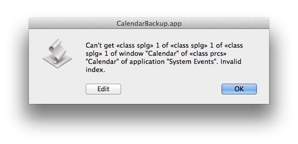

Following up on my thread Mountain Lion Calendar - exporting calendars as .ics files I was wondering if anyone could take a look at the Mavericks Calendar.
The script doesn't seem to work anymore and the failure message I receive is:
Can't get <<class splg>> 1 of <<class splg>> 1 of <<class splg>> 1 of window "Calendar" of <<class splg>> "Calendar" of application "System Events". Invalid index.
I assume it's a trivial fix but I've been unable to find the problem. Any help is much appreciated. Thanks!

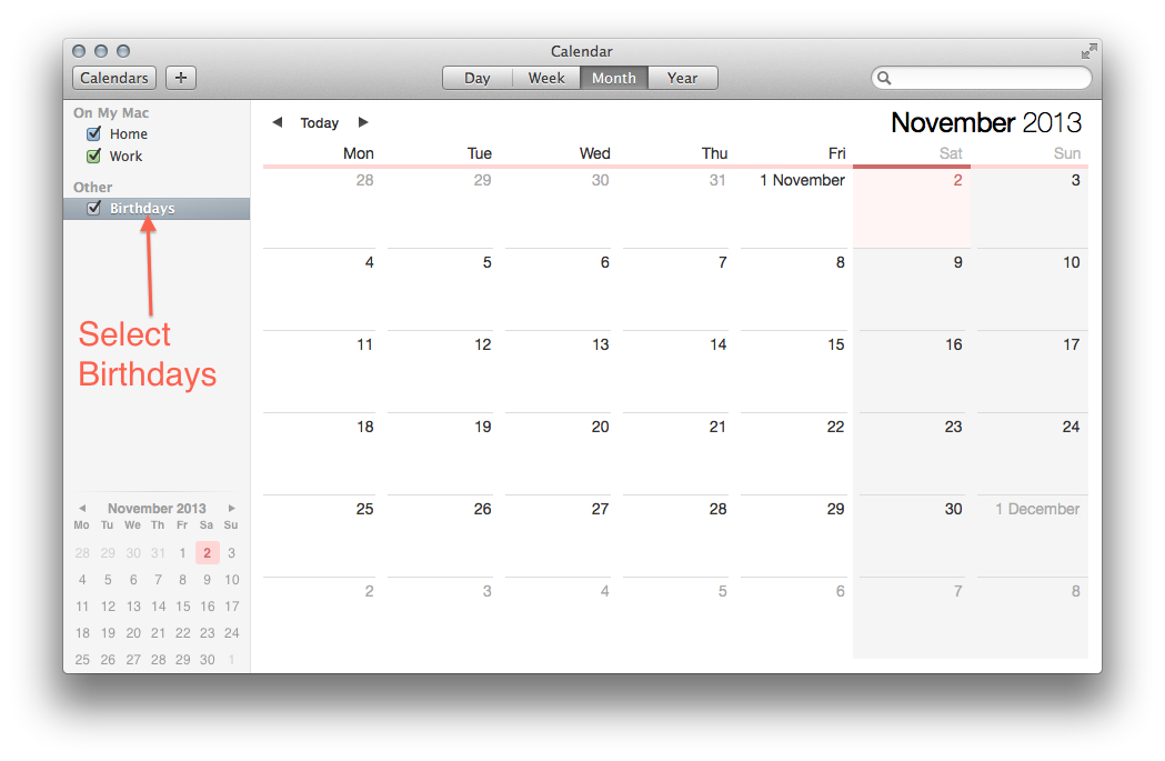

Note : Before running the script please make sure your Birthdays calendar is selected otherwise the script will fail. I know why it fails but don't really have time to fix it.

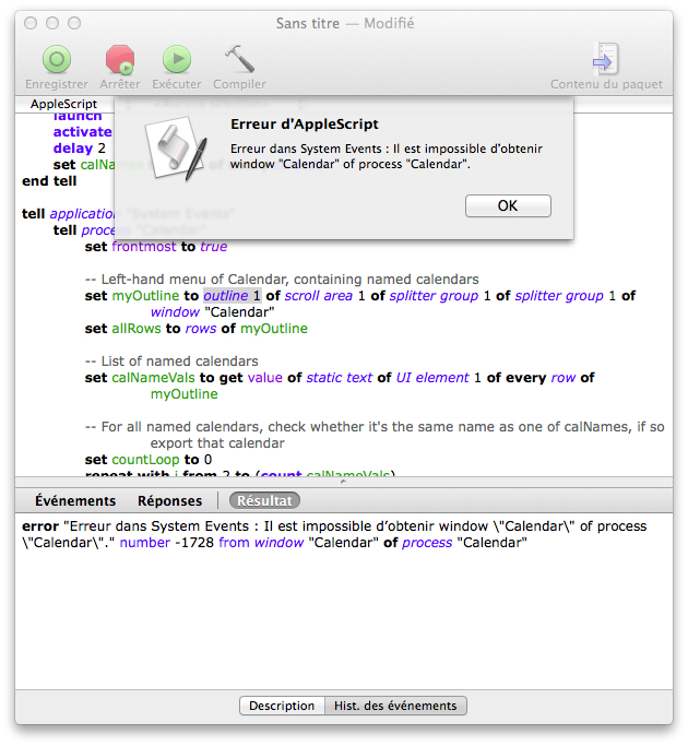

Hello Schubi,
I try to use your script (under Mavericks 10.9.5) but I get this error :
it's impossible to get window "Calendar" of process "Calendar"
(pls see image attached).
Could you please guide me how to address it ?
Thanks in advance for your time.
Wonderful forum !!!
Loyd

Try this with window/button/menu item names en français :

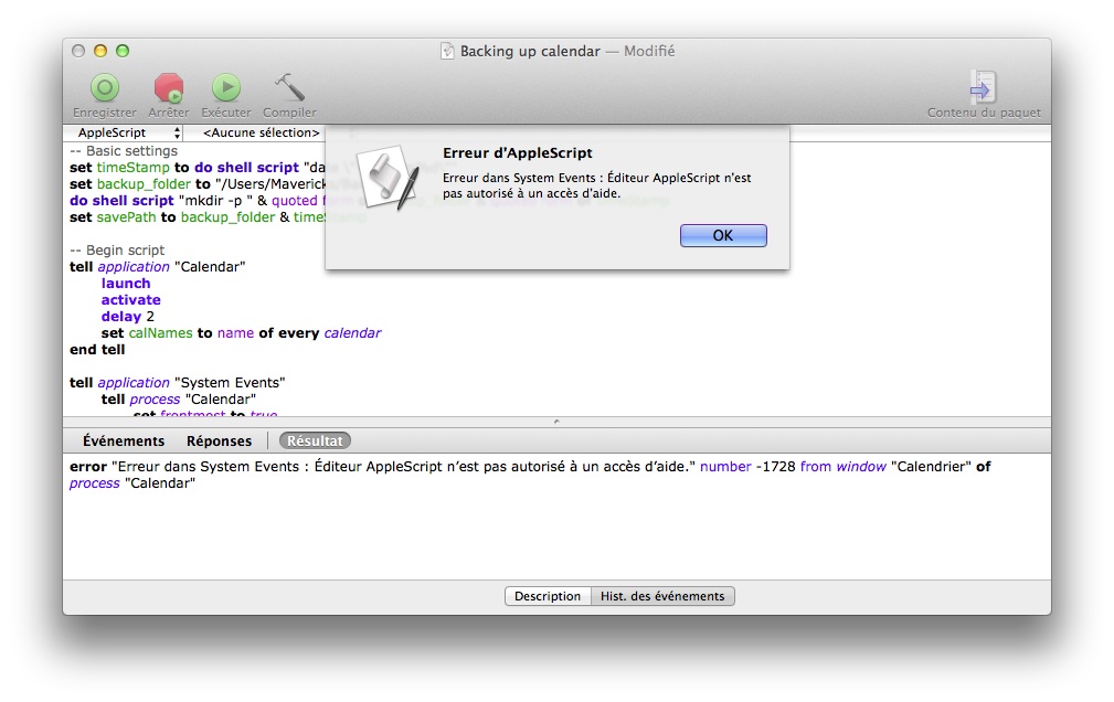

Thank you Kryten2 !
I use your suggestions without modifying anything (just the first code not the second "Index reference form :..." wich I do not understand where to include it 🙂)
I get this second error (pls see image)
What can I modify to got the script works ?
Thanks for your time
Edit : Wrong image attached : corrected !

Thank you Kryten2 !
You are aware that this is for Mavericks right? Try to enable access for assistive devices and applications.
