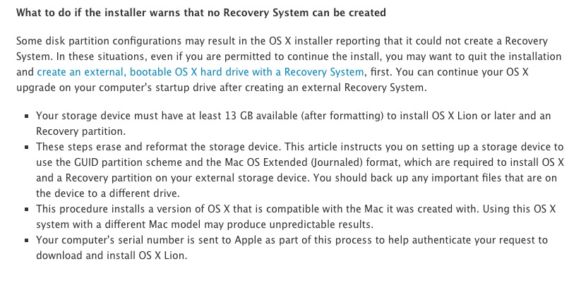

As mentioned in my title, when I go through the install process for Mavericks it starts to install, but then says it has failed because the recovery system could not be created. What does this mean, and how do I solve it? Thanks in advance.
It gives a web support address to /support/no-recovery, but that does not help at all.
I have a 2010 Macbook Pro 15" with a 256 Samsung 830 SSD which I assume is the issue. I transferred everything via Carbon Copy though so it should be identical to my previous hard drive.
Looks like Carbon Copy Cloner failed to create the recovery partition when you copied the contents from the old system.
Typically OSX will create the a recovery partition, but since you used CCC, perhaps that messed things up. Did you try to repartition the drive and install Mavericks as a new system and then migrate your data from your old system via CCC?

Hi, thank you for your response. Looks like your right and it is CCL. I've not had a chance to sort it out today other than create a bootable usb drive for Mavericks.
But just to check from what you said, if I create a new partition on my SSD and install Mavericks on this bit, that would be a fresh install.
If successful, I can then transfer all my data across from the original partition via CCL or use my time machine backup.

I'm stuck
So I did everything on here:
http://support.apple.com/kb/HT5911
Up to the point where I now have mavericks on a USB flash drive which is extremely slow and I don't know how to get the OS onto my macintosh HD 😕 any help please? Oh and also will getting the OS onto my HD format everything on it? Thanks 🙂
