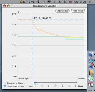

thanks for the help dhartis! i installed CHUD and just look at the attached image...
from 60 celsius to 45 in 20 minutes!
no i have a super silent, super cool mac... is it cool or what?
thanks! 🙂
