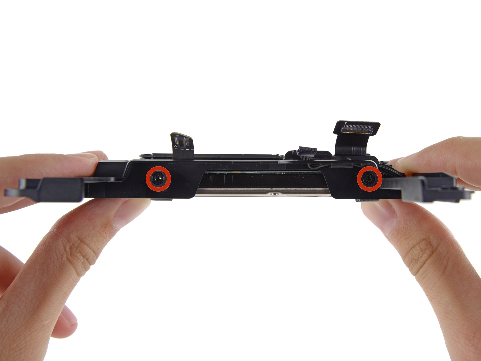

@j1104638 with a 7mm disk in, you will have about 4mm clearance to the base of the mini
and with a 9.5mm disk in, you will only have about 1.5mm left.
So even if you don't use the rubber grommet and the screws, maybe 12.5mm is ok, but definitely not 15mm. Then again, 12.5mm pretty much died at 1TB, anything higher than 2TB seems to be 15mm.
Reactions: j1104638
Similar, as you can see, with the 9.5mm inside, you have about 1.5mm clearance at the top if you don't use the screws and grommet, and a 1.5mm below so you might be able to fit a 12.5mm.
