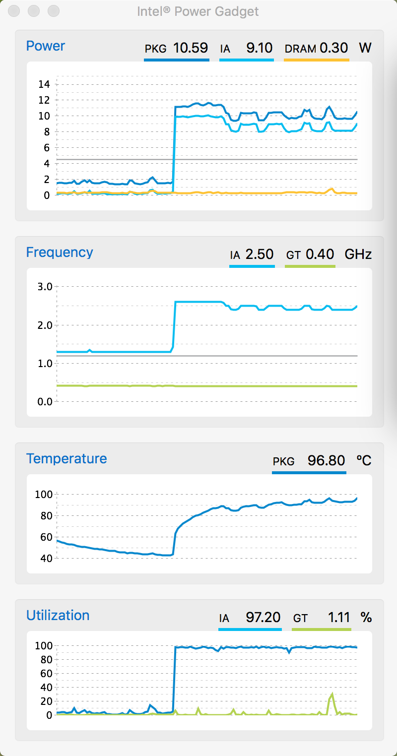

I installed the latest 3.5 release of Intel Power Gadget and redid the test on my 2017 m3 MacBook. It jumps to 2.6 GHz, then throttles to 2.4-2.5 GHz. CPU package power utilization is 11 Watts, and 9 Watts for IA. Idle is 1.3 GHz.
