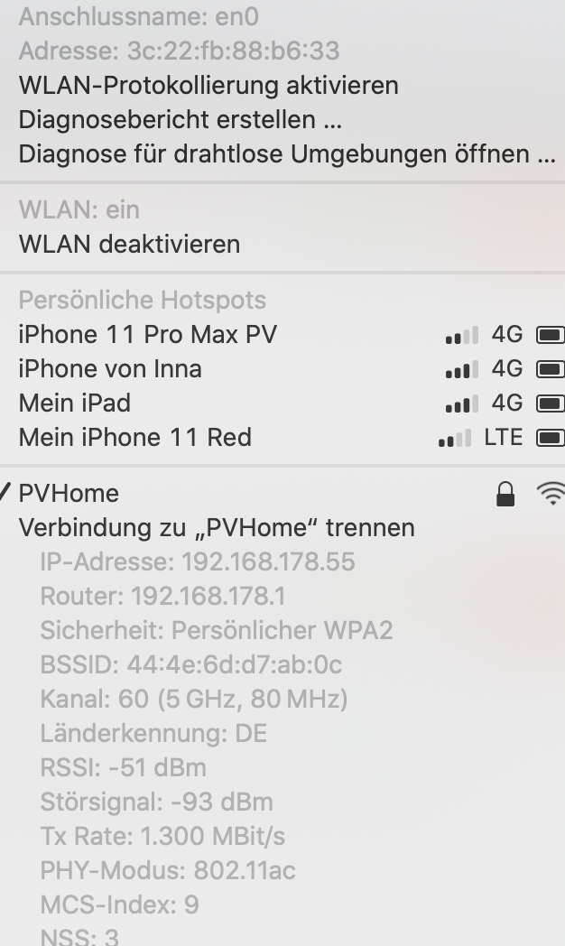

Anyone with a MBP who is getting a higher Tx Rate than 866Mbps? You can press Option and click on the WiFi logo in the menu bar to see your connection details.
I am getting higher speeds

I’m getting 1300Mb/s if I connect directly to my broadband provider’s router. This is the 4 Thunderbolt model.

I have a 16" MacBook Pro with i7 6 core, but that isn't important. Your router configuration is important, the interference and the distance from the router. Try experimenting with various channels and try to use higher channels if possible (but that isn't a guarantee for more throughput). Avoid all channels below channel 52, otherwise you will be getting less throughput.

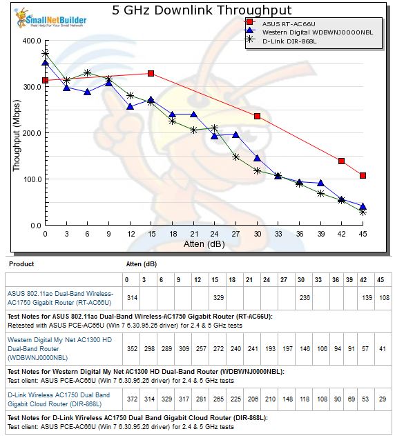

Don’t expect to hit a theoretical max of your AC router. SNB tested it several times and as far as I can tell, 1300 on AC is off the table.
